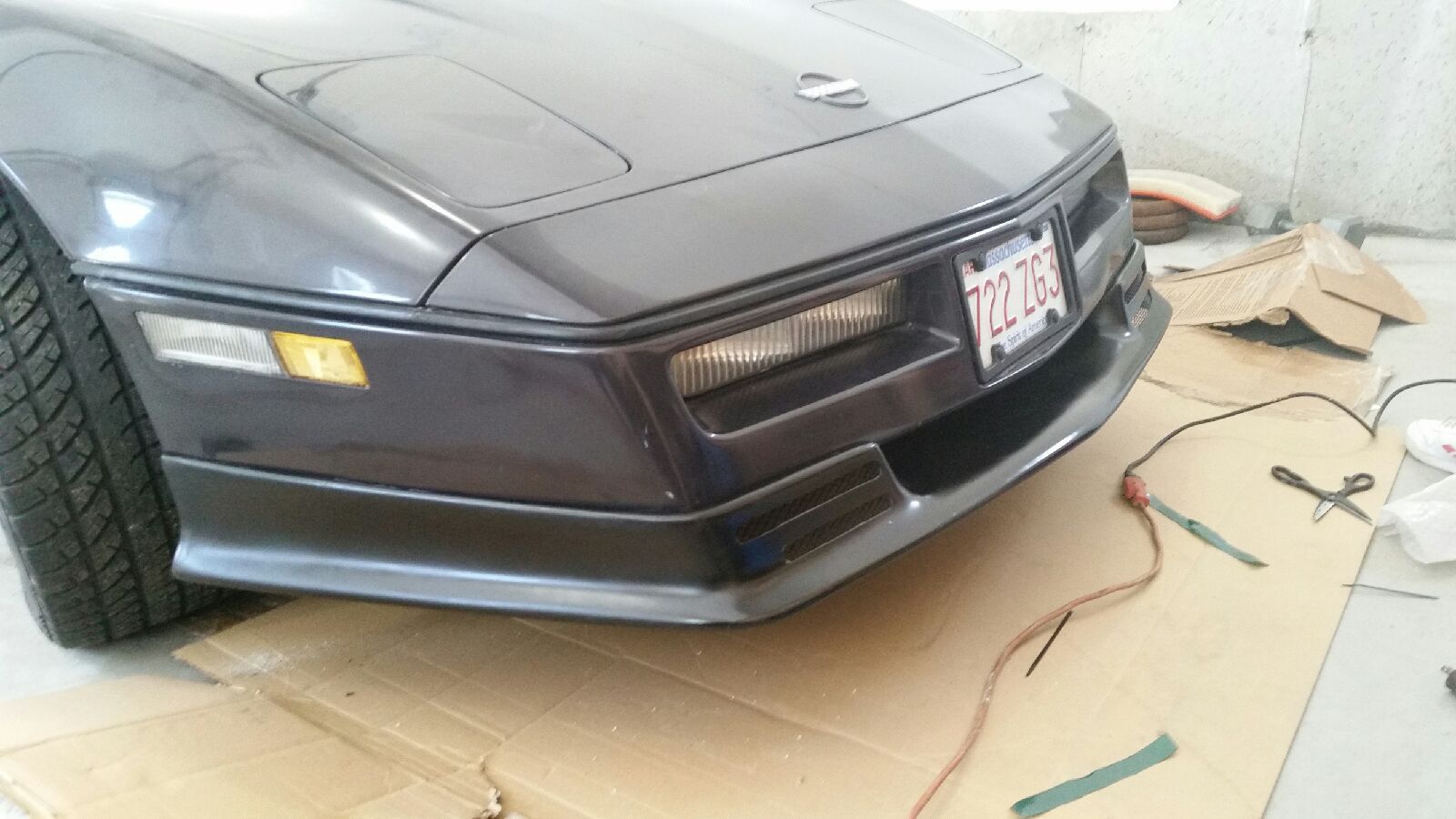

This was done over a years time off and on. The Duraflex was not an exact fit as I believe it also is desined to fit the early to late c4 and early c5 that have a subtle different front end. Here are some pics regarding the front air dam.
Shot with a black rattle can satin.
Just enough to fill the bottom front nose without fear of scraping driveway curves or speed bumps. It also has a flat center piece that directs air toward radiator.
