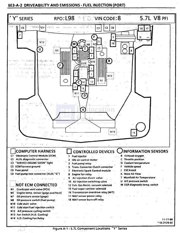

can anyone tell me what this sensor is , its located on drivers side

On an 89 it is the temp sensor that turns on and off the fan in front of the radiator
it is an 89 , thank you
