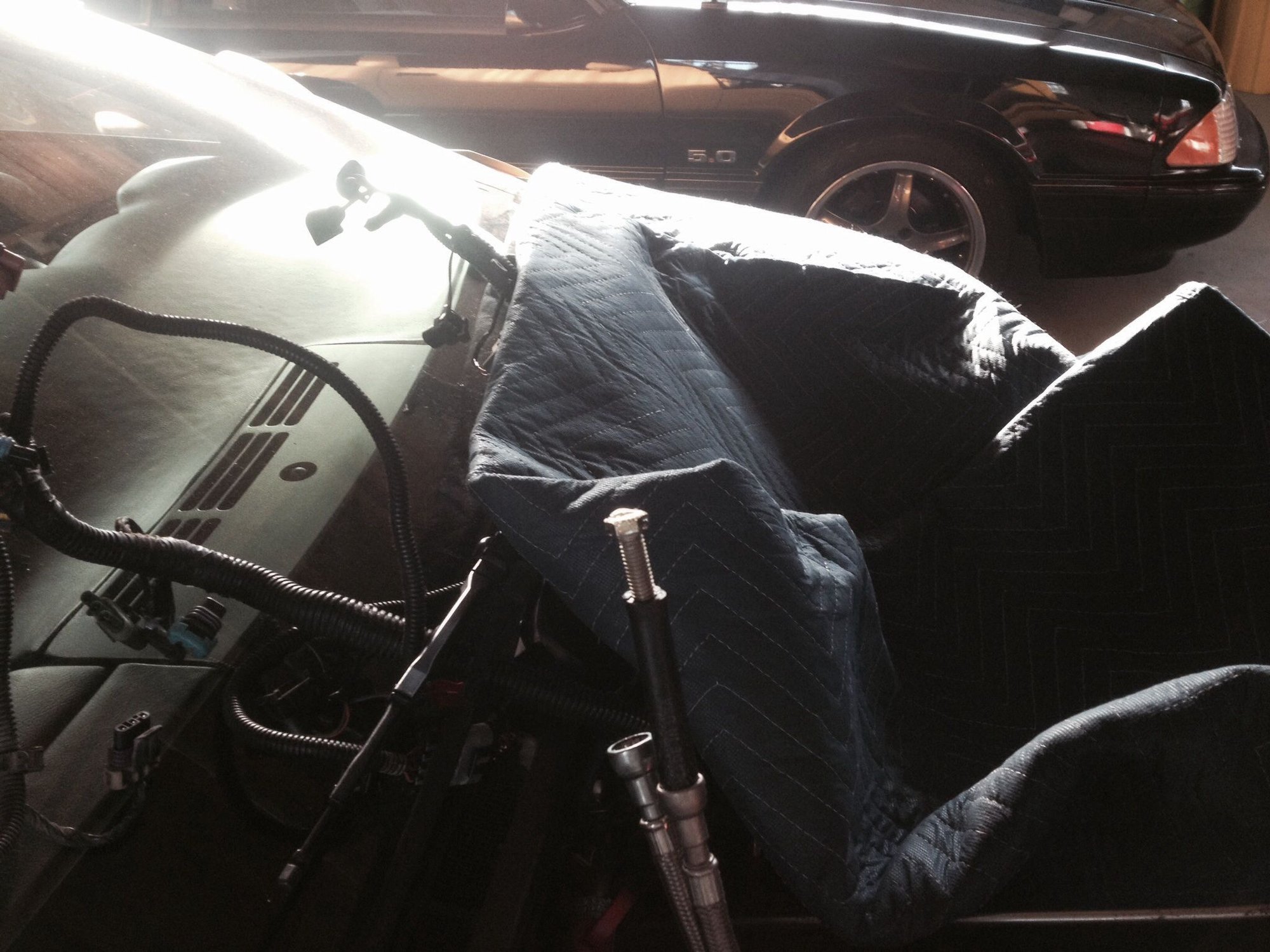

I recently finished my cam swap and had the same issue. I ended up just pulling the fuel rail with injectors out of the intake, hooked that back up to the fuel lines and just laid that assembly up on the windshield on a towel. I even had the fuel cap off from the get-go and still had this problem.
