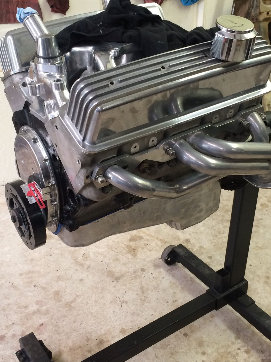

This is the only pic I have right now but I think that's the sensor on the drivers side
Yup that's it.
Also FYI that timing cover may need water pump spacers, just something to check. If so then you may have to space your other pulleys too or press the pump drive hub on a bit more. GL
