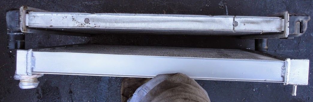

Hey All, just thought I'd give some feedback on a thicker than stock aluminum rad that costs under $200.
Bought it through Amazon for $185 w/free shipping. Search for "Chevrolet Corvette Full Aluminum 3-Row Racing Radiator - C4 5.7L V8 L98/LT1 ZR1" sold by Auto Dynasty
Basically it costs $90 more than a generic replacement so I decided to give it a try. I'd say its a 4 out of 5 for quality. At this price point I'm sure its not made in the US. But.. it appears to have decent quality.

As for the radiator design I give them one ding. The upper coolant hose pipe is too close to the e-fan shroud. (you can see its closer to center of car in the pic below). It'll "fit" but I'd suggest keeping everything loose and putting that hose and clamp on. Then tightening everything else.
Here are the rads specs:
- Constructed of High Quality T-6061 Aluminum Construction.
- High Performance JDM Spec. 3-Row Racing Design
- Light Weight Direct Bolt-On OEM Fitment or Replacement.
- Stronger & Higher Capacity for Coolant than Stock Units
- Highly Increase Cooling Performance
- Overall Size: 27.5 x 18.00 x 2.50 Inch.
- Core Size: 23.50 x 18.00 x 2.13 Inch
- Inlet/Outlet Diameter: 1.50"/ 1.625"

Oh an btw, they are not kidding about the weight. It's approx 2/3rds the weight of the stock unit. Definitely noticeable. Probably offset by the increased mass of the extra coolant though.

Great Thread. Wish you would of weighted both first off, to see exactly how much more you were adding to the front nose. What ever it is, its well worth it.

my scale isn't very good for this kind of shape. In my estimation the weight when filled w/coolant would be about identical to each other.
