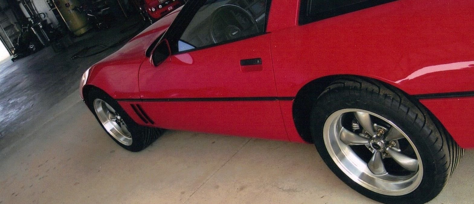

Old Apr 19, 2015 | 11:26 AM
project C4's Avatar
project C4
Joined: Apr 2004
Posts: 621
Likes: 37
From: Texas
Sorry I didn't see this sooner...
Yes, direct bolt on 10.5 x 17 torque thrust M 44mm on all four with 285/40 gsd3's
