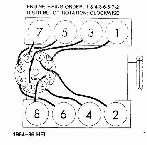

hey , my son and I are working on my 89 coupe , I got called into work and when I got back my son had pulled all the plug wires and didn't map where they go , so I need to know what post on the dis cap is number 1 in the firing , any help would be greatly appreciated
