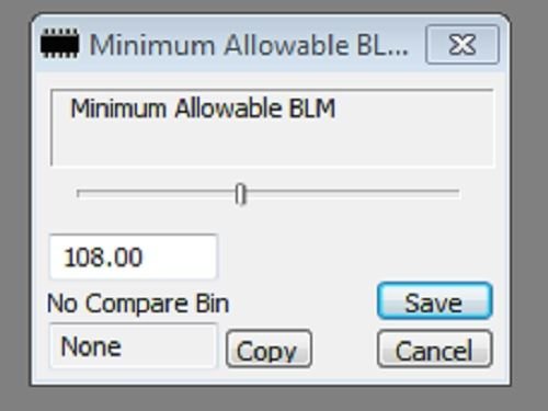

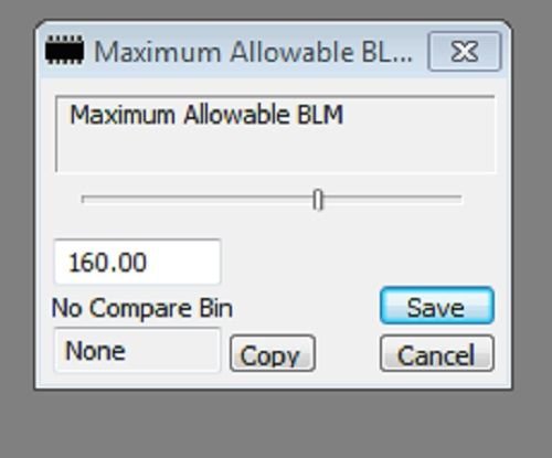

i would buy a cable and download Tunerpro rt, datalogg that car and see what happen...if you are running lean you have high BLM's (read block learn multiplier)the O2 sensor is reading more oxygen than expected by your tune...high BLM's are usually in the 140-150-160 range in Tuner pro.Tunerpro has a section for trouble codes too,it says for example code 33,or code 44 if you have codes stored in memory...
here two pics for the minimum/maximum range of BLM's in a 85' tune.
