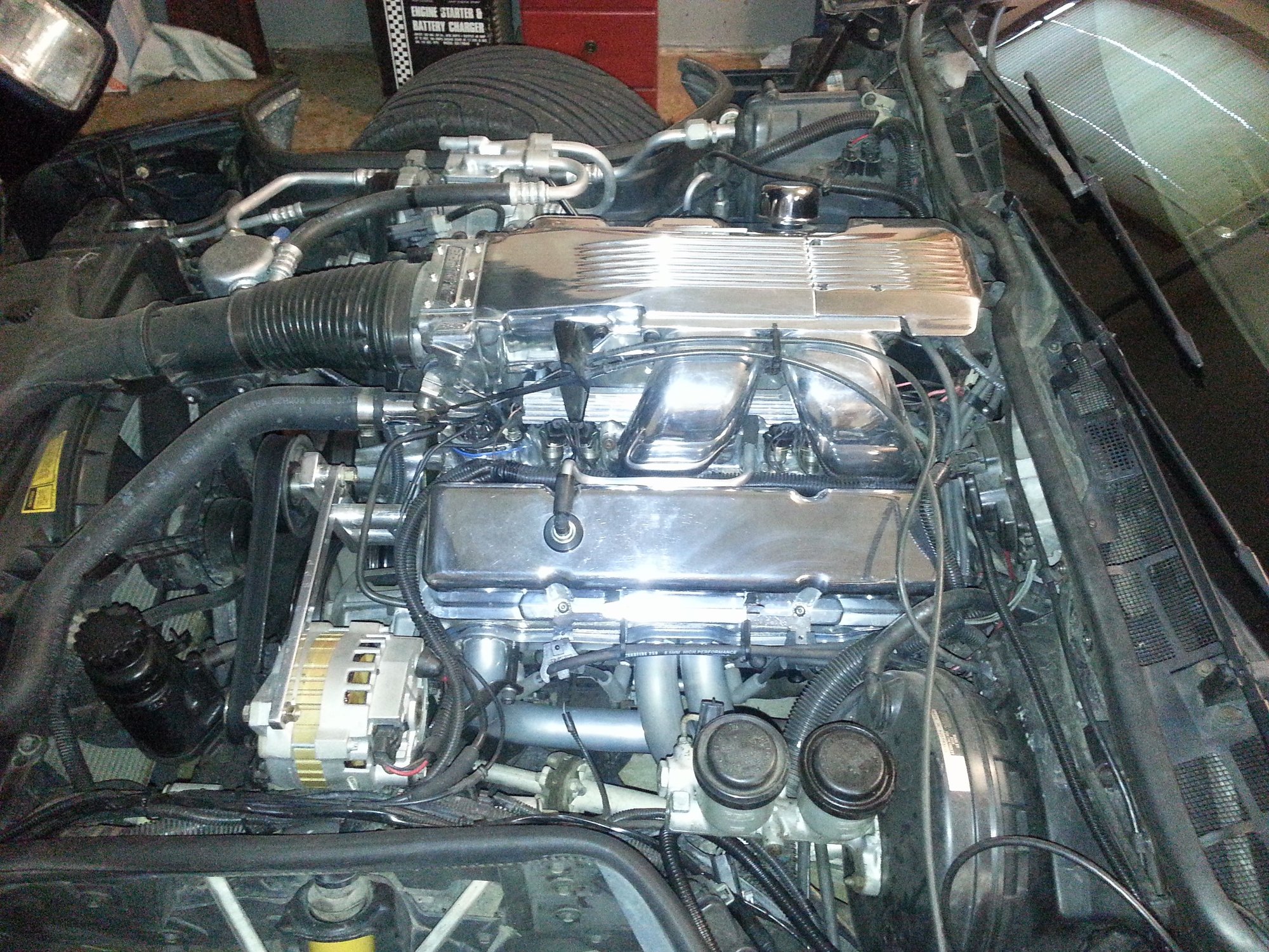

I'm looking at replacing my computer with something more up to date. Does anyone have experience with the Haltech Platinum Sport GM? It sells itself as a plug and play replacement and lists 89 TPI as supported. The only caveat seems to be support for automatic which isn't a concern for my 6speed.

Yeah, it's a bit pricey but ODB1 is difficult to support modifications. It's at the shop getting test fitted with the GM module, should hear something back today.

Initial startup with the new computer was successful, they're tweaking the tune now and then will get it on the dyno.

Car is all put together now and dynoed in at 339rwhp. I had hoped for more, but I guess it'll take more mods. ;-)

383 and a bunch of this and that. Other than replacing the TPI that I wanted to keep there probably isn't much more I can get out of it without forced induction.

Yes, the TPI intake is choking that 383.....I learned that...had the Edelbrock runners and base....not much improvement
