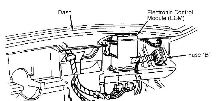

You only need to remove the lower passenger trim panel.
Then look up into the dash and you will see the ECM bolted in. If I remember correctly they' were 10mm screws.
