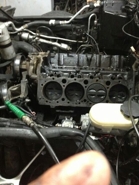

This photo was taken a year ago while I was doing my top end
