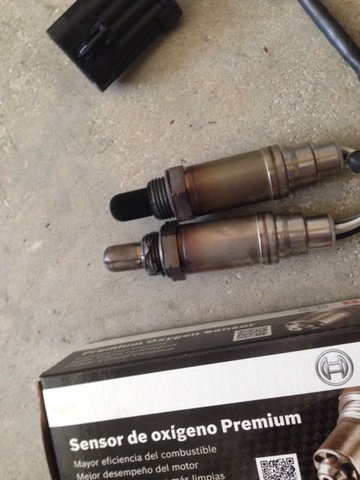

Next, I replaced the oxygen sensor (picture below), which was coated in carbon as I suspected. I test drove the car afterward and it has its normal amount of power, since I've known it anyway, and no Service Engine Light.

Last edited by 94c4seminole; May 29, 2015 at 12:22 PM. Reason: Added photo of old and new O2 sensor
