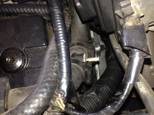

UPDATE: I went to an exhaust shop and they were unable to hear a leak coming from the exhaust manifold. I was told to check it tomorrow morning when it is dead cold, and I will do that. I was also told to look into the Air Circulation system to see if maybe it is the check valve. I am not sure how to test that though.
They also pointed out to me this potential vacuum leak that could be causing a lean condition (see picture).

Does anyone know what this white vacuum thing is? Is it supposed to have a vacuum line connected to it? This on the driver's side air injection hose near the firewall.
To Need advice on diagnosing a recurring lean O2 sensor code
Old May 28, 2015 | 02:19 PM
antfarmer2's Avatar
antfarmer2
Joined: Mar 2015
Posts: 15,926
Likes: 579
No but mine has nothing on it either
