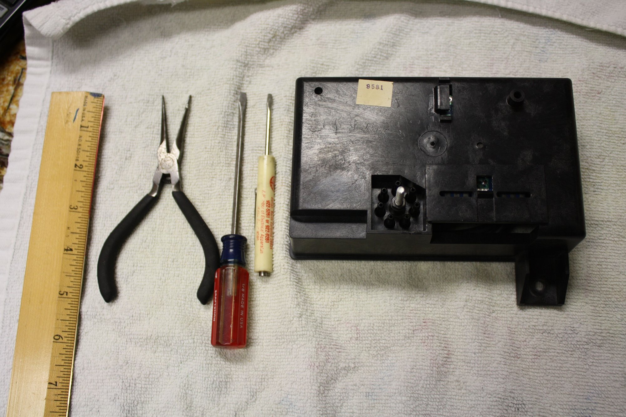

You are going to need small tools as shown.
Your programmer will look something like my 88 programmer.
You can see where the 7mm mounting screw goes. You may have to remove the seat or just the seat cushion to get at it. You will need a ¼ inch driver with a long extension to remove the screw.
The 2 tabs at the top slide into 2 mounts in the firewall.
There is a bolt that holds the silicone multi tube block from the inside of the programmer to the backside. The head of this bolt is recessed and you cannot get a socket on it. The only way I know is to remove the very thin press-nut on the tube side which is almost hidden in the middle of the tubes and it is shaped round is by breaking it. Once you pull the electrical cable off you will be able to see it. Use the small screw driver to prize the press-nut up so you can get a hold of it with the small needle nose pliers. Twist the pliers back and forth until you break the press-nut. Be careful of the tubes. This is why you need small pliers. When the press-nut breaks and falls out you can prize the silicone block out of the programmer. If Cliff H. can attach a photo of the hose block it would be helpful. Mail your programmer to batee.com and he will fix it. Send the head unit to him also so he can verify it working properly. Cost is going to run around $200. Don’t buy a remanufactured programmer. I did and the programmer did not function correct so I shipped that programmer to Bryan at batee.com. He’s very quick and good. I now have 2 working 88 programmers.
To re-install you will need a nut to replace the press-nut. My new nut fits a 9/32 socket, small enough to not interfere with the hoses as you attach it. You don’t need the ¼ inch driver just use your fingers to tighten using the socket. Hope I didn’t leave anything out. PM me if you have a problem.

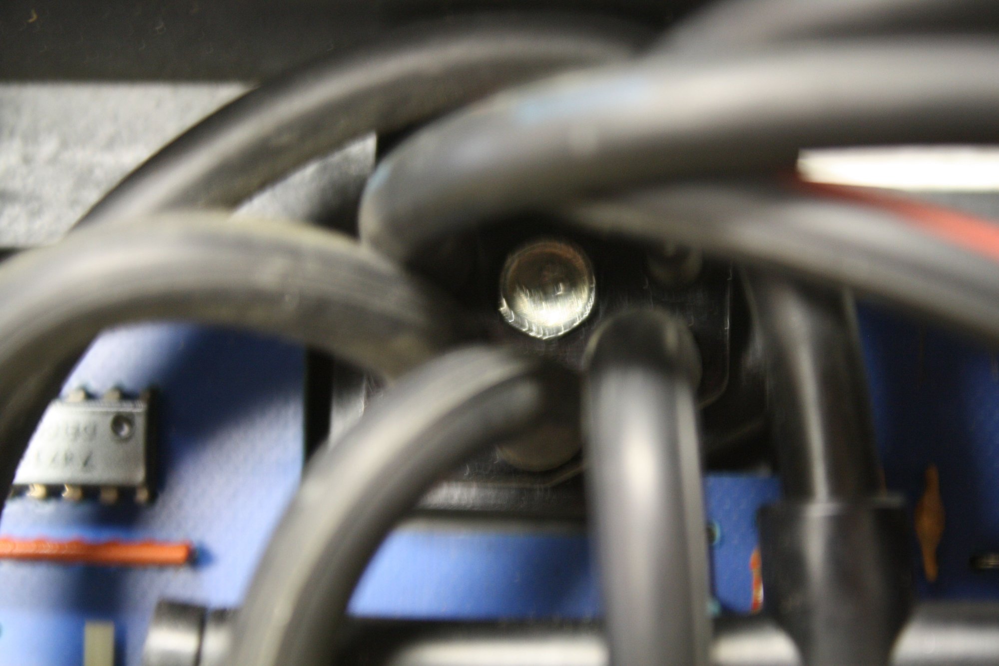

The silicone vacuum line block looks like this:
This picture shows how the silicone block is held in place. You can unscrew the press-nut with long nose pliers (and replace it with a real nut):
The black plastic piece has a hex-shaped depression molded into it that the head of the screw fits in. You have to take everything apart from the outside.
