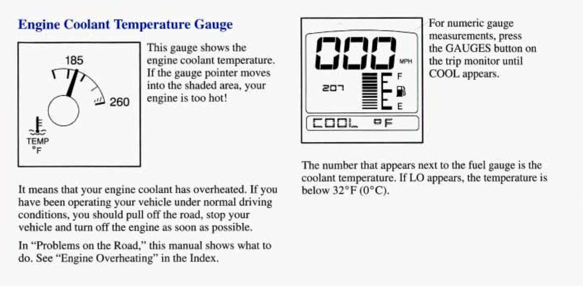

There is no outside temp displayed in the location you list.
The only outside temp display is show on the climate control system above the radio.
The "Gauge" button will cycle the display though various readings, but outside temp isn't one of them.
Volts, Engine Coolant Temp, Oil Temp, and Transmission Fluid Temp for automatic transmissions.

had a chance to look at the display last night. When going through the gauges and getting the digital engine temp it displays "cool" and "0f" where the mileage should be . I assume the "0f" is for outside temp because it usually is approximately the same as the outside temperature. I think your talking about a different year corvette, not a 94.
NO!
I am talking about your 1994 LT1 Corvette.
Again, that is NOT the outside temp display.
You just described your engine coolant display. It lists "Cool °F" meaning the engine coolant is being displayed in degrees Fahrenheit.

I have a 94 that gauge reads off the sensor on your water pump

Wow, son of a gun, that's makes perfect sense. What was I thinking. Thank you very much.
