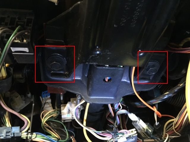

Here are the two bolts, and plate (top of the photo), holding the steering column up in place snug with the dash.
Bolts and plate removed.

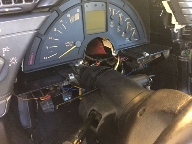

Lowered steering column. Now you can get the bezel and cluster in and out without busting up the place!!
