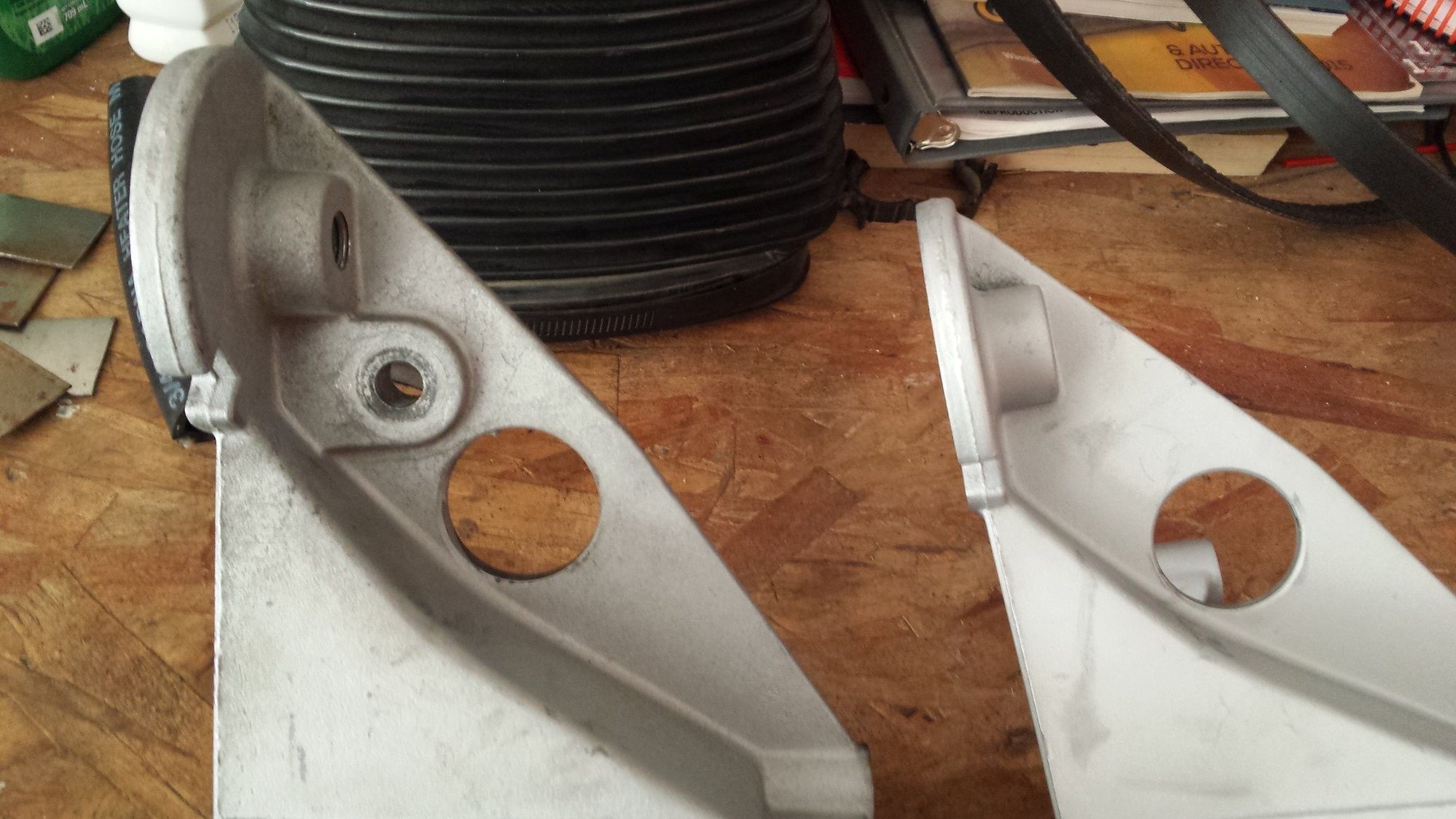

So my AC bracket broke. Long story short I received another bracket but it's missing a hole. The hole that's missing goes to some sort of support bracket on the engine block. Does anyone know if it's needed? Apparently the bracket I received is the newest listed GM part number. I have a 1990.
My original has 10105236 stamped on the back, new one has 10055751.
I don't even see part number 10055751 listed in my parts catalog, only 10105236 for the compressor mount bracket.
Hi
3 generations between 88-91 in a/c bracket design and support brackets. These support brackets have been added to stop the a/c brackets from breaking, they are surprisingly fragile.
See pics below where all the supports connect to.

Originally Posted by gerardvg
Hi
Thanks for sharing that. The bracket on my 90' has all support braces that you posted. I assumed the bracket was the same from 88-91. I have another one on the way, just have to wait for it to get here.
