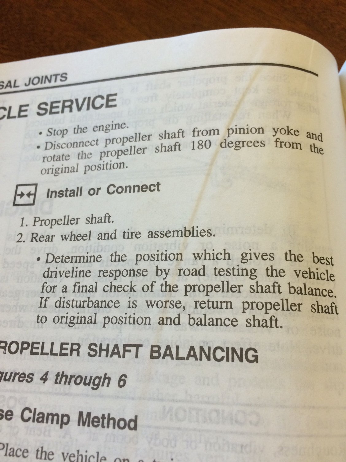

I broke out my service manuals as I too have 95. If you like I can email you some of the pages. I found this interesting :
Old Aug 3, 2015 | 06:04 PM

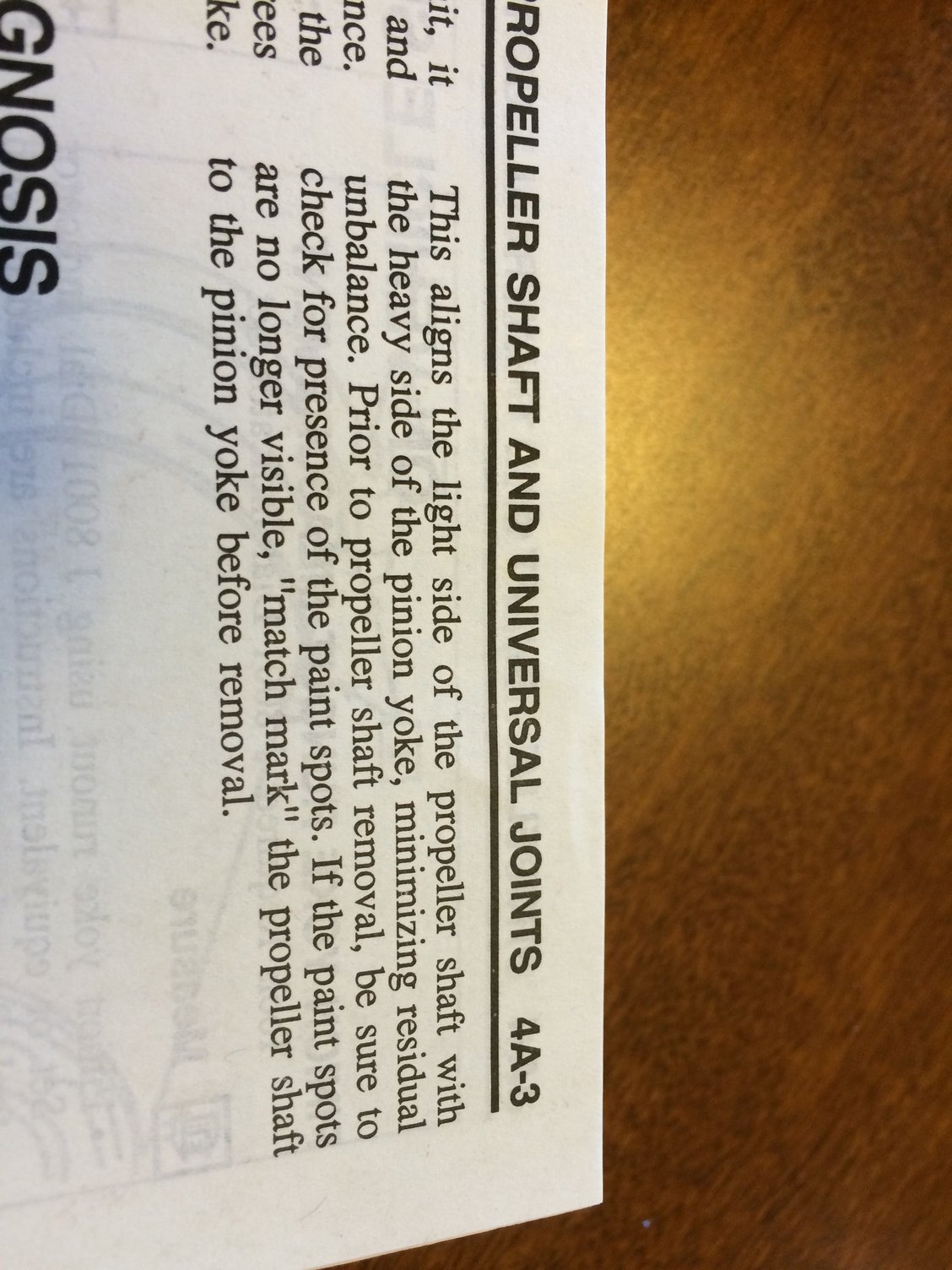

chadk's Avatar
chadk
Joined: Aug 2014
Posts: 287
Likes: 9
From: Toledo
2nd paragraph

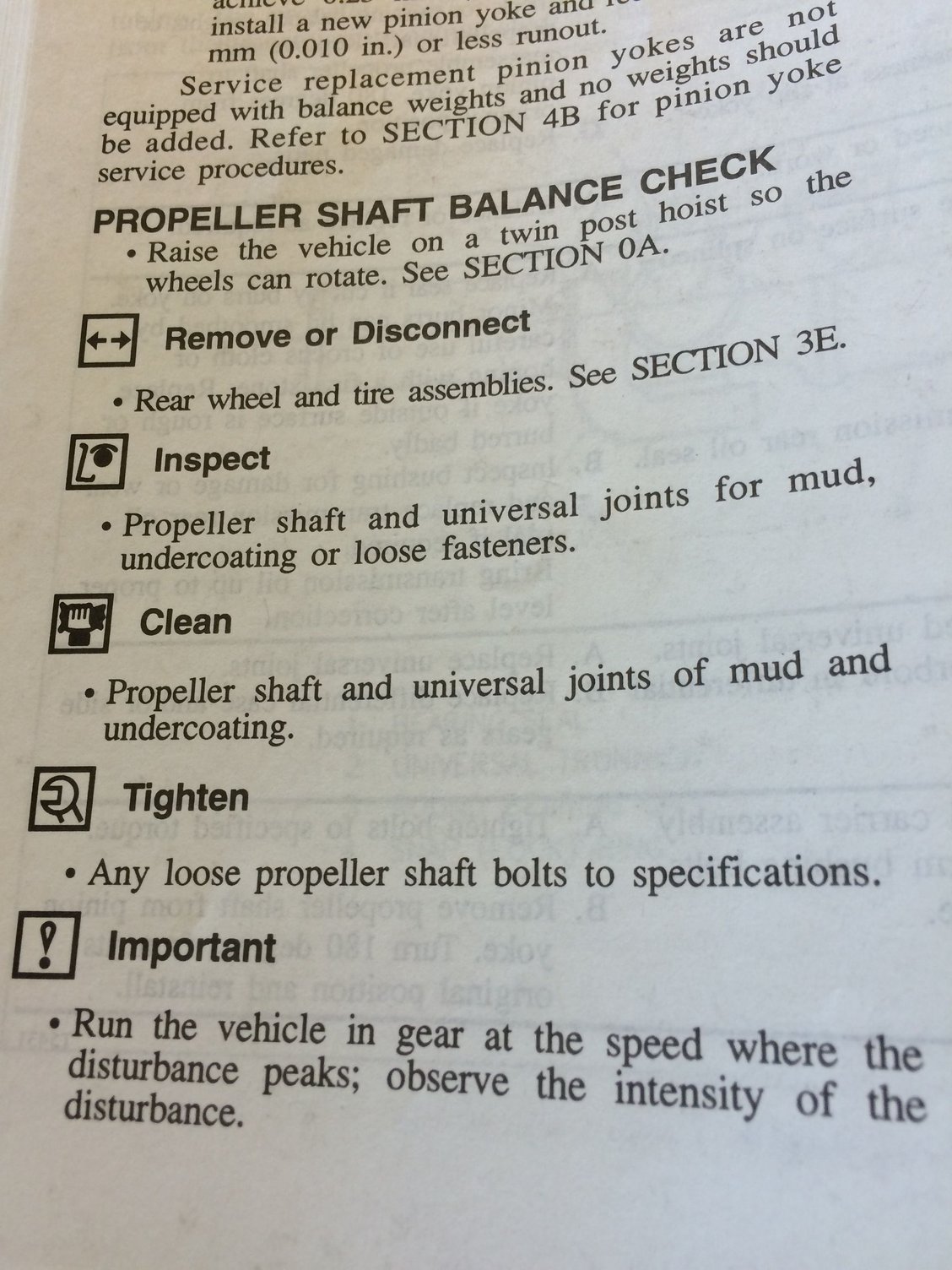

Old Aug 3, 2015 | 06:13 PM
chadk's Avatar
chadk
Joined: Aug 2014
Posts: 287
Likes: 9
From: Toledo
To U Joint/Half Shaft Advice Needed
Old Aug 3, 2015 | 06:15 PM
chadk's Avatar
chadk
Joined: Aug 2014
Posts: 287
Likes: 9
From: Toledo
2nd paragraph
And it goes on with how to balance. Lots of good info.
