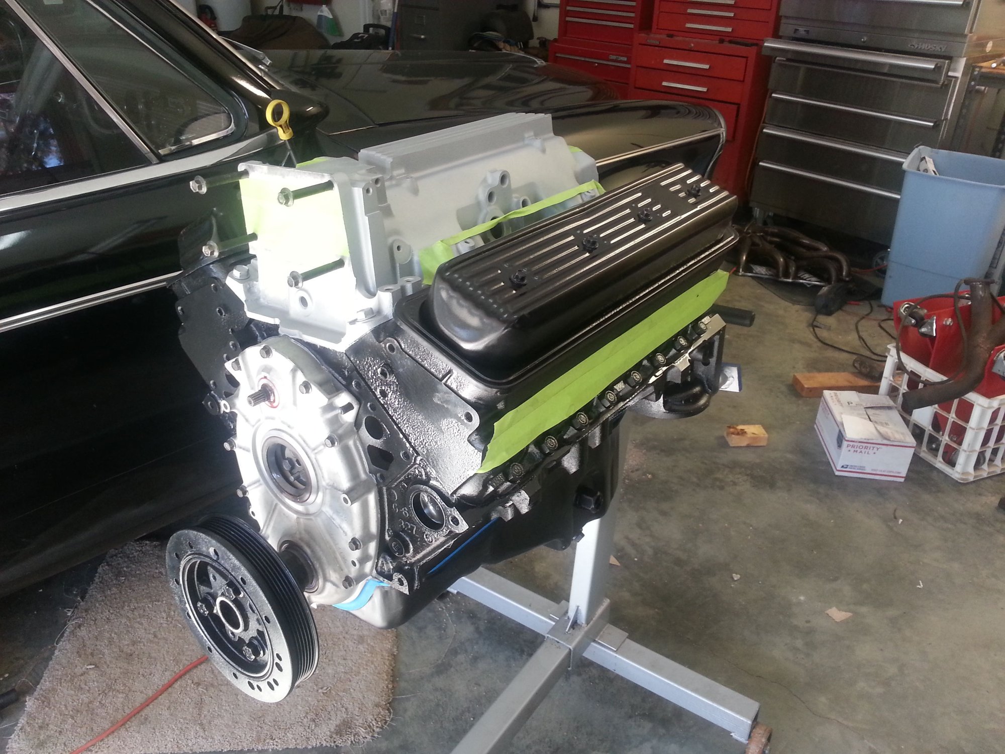

OK, its done
Decided to go back stock (almost); used an LT-4 cam.
new: standard bearings, 30 over pistons, rings, roller cam, rods, springs, lifters, timing chain and oil pump. Resurfaced heads and manifolds, magnaflux surfaces and ground valves, replace guides.
Now it needs a home.
