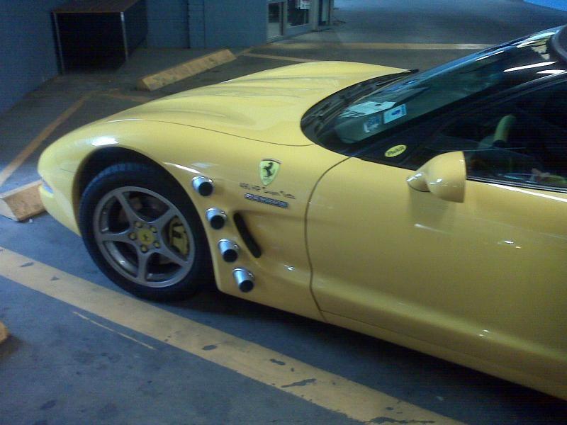

Here is another Corvette owner with a creative exhaust:
