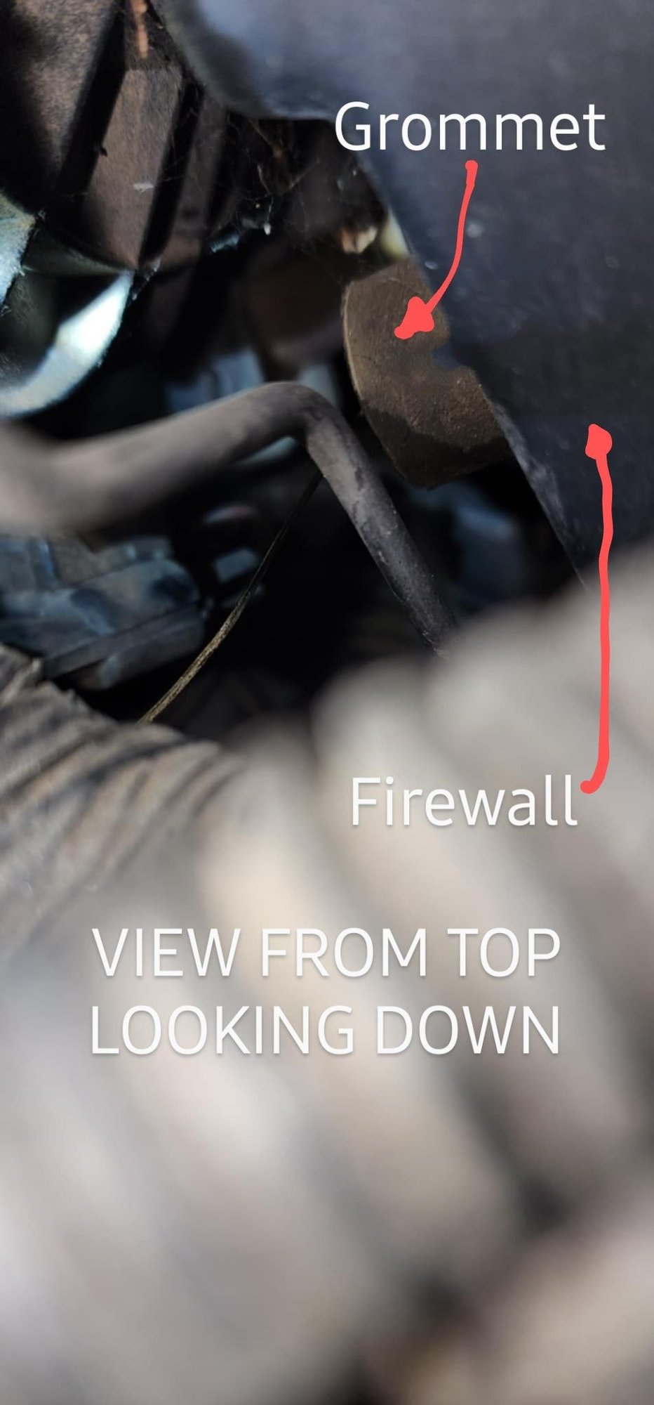

Default Today the vacuum line for the cruise control was replaced.
There is a large rubber grommet in the fire wall that allows the line to pass thru the fire wall. The grommet is about 1 inch dia. & projects about 1" into the engine bay (see photo below). The replacement line was tampered at one end to allow the line to get partially thru the grommet. The line & grommet were well lubricated. Enough line (hose) was pushed into the engine bay that a long needle nose pliers was able to pull the rest of the line into the engine bay. The fit between the line & grommet is very tight so it would be best to lubricate the whole line. My line wasn't well lubricated & it ended up that the new line pulled the grommet out of the fire wall into the engine bay. With the line thru the grommet I was able to get the grommet back into the fire wall. Hoping that it will be watertight.
