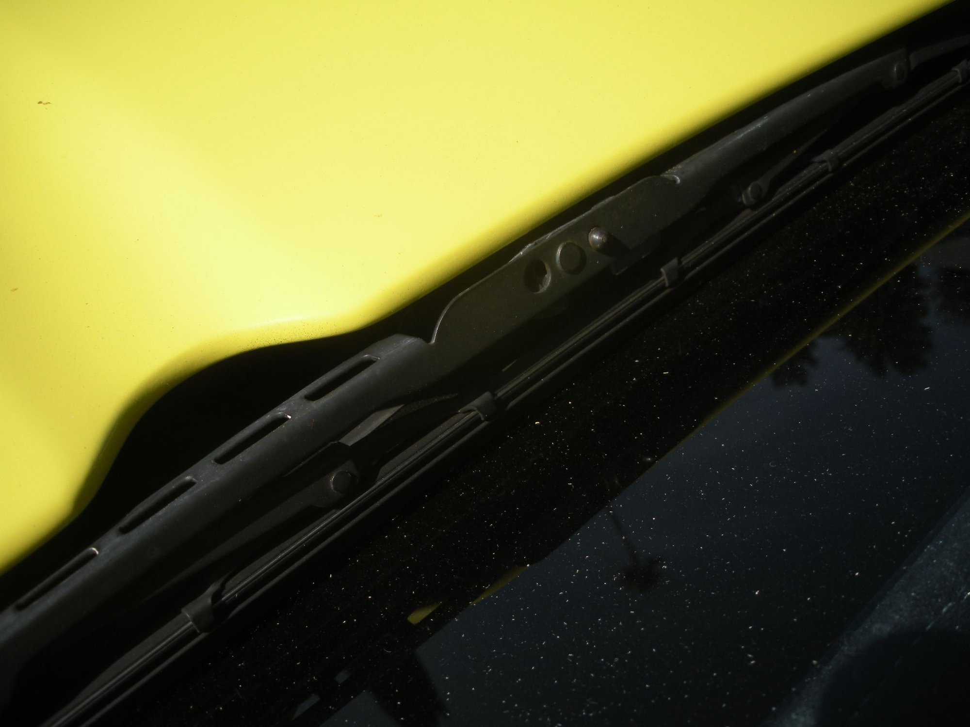

I found that Michelin 20" blades are a nice low profile, and they have replaceable inserts, too. Here's a photo to show their good fit under my hood:
I was surprised to see them at Home Depot!
can you post the PN of those Michelin's?
