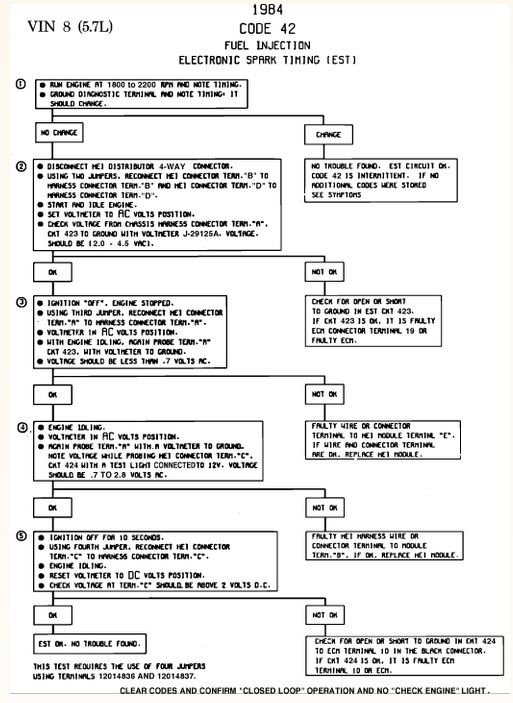

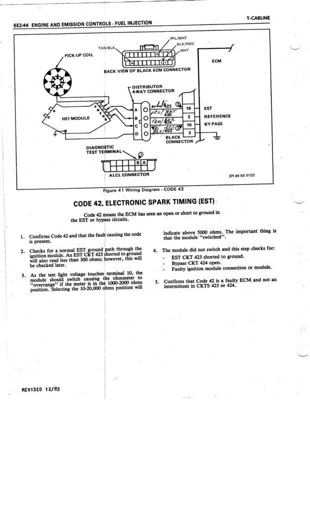

code 42 is the EST (electronic spark timing)..
When I had this problem it ended up being the ECM..

CEL flashing indicates a misfire, and code 42 with the intake backfire definitely narrows it down to timing. The above diagnostic procedure should lead you to your root cause!

You will get an error code 42 when you open the EST connector to set the timing. Reset the ECM and see if it still comes up.
