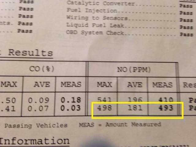

Fired it up and computer picked up the change to higher psi injectors quickly. Runs rock solid and the power difference is a nice bonus. It has never run this well. Sweetness!
I thought it was rated at pph (Pounds Per Hour)? PSI is pressure and should be around 43.5? Maybe it has never run that well because your 5 or maybe even 8 were clogged. I'm not sure what the effects of a 30pph injector swap are when you are rated 24. That is a 25% change. Anyone know if the ECM is capable of that much adjustment?

Pounds Per Hour sounds like the correct terminology thanks for updating me Aklim. I was concerned with the jump but couldn't find anything concrete on forum so eventually just went with the swap. Next smog test is two years away and I may need to look at ECM at that time. As well as it runs I have hopes it will slide on through. A noticeable power increase since swap, however it was running poorly prior to the change. Thanks for input!

Sometimes the message can get muddled through different posts. The simple message is The Accel 150830 Fuel Injector set of eight matched injectors swapped out perfectly for the stock injectors. The ECM adjusted for the higher fuel flow fairly quickly and the vehicle is not running rich. Car now runs very solid, idle is smooth and acceleration or "floorboard power" is better than it has ever been.
Fuel pressure is good and the EGR system is functioning correctly. If anyone has a question feel free to drop me a note!

Question is why it can make such a quick adjustment

Leaves me wondering also how the computer could compensate for such a large change in injectors.
But I guess the bottom line is that it is working for him. If it is working, why fight it.

Under certain circumstances it might be able to compensate I suspect. Besides SOTP feeling is so subjective I would hardly trust it personally. You ever not see the kids tell you how fast the car feels because they tossed money at it without proper verification?
Maybe because almost every too good to be true" situation usually plays out thst way in the end?

aklim, we both have this "gut feel" that this is not right. The only way to be sure would be the sniffer in the tail pipe. Or if that is not available, read the plugs after driving it for awhile. SOTP, like you say is subjective.
But he does indicate that it is running better and stronger. At WOT?? or casual driving down the road? Guess that at WOT it might be good, but would eventually load up running rich just casually driving down the road.
Driving time will tell.

Good point regarding loading up over time under normal driving conditions. It has a little over 200 miles on it since the swap and tail pipes appear clean and no noticeable odors when idling for extended periods. When I get the chance I'm going to run it over to smog test center and see how things look, you guys are making me nervous . Next test isn't due for two years but if I need to make adjustments I don't want to wait till last minute. Are there modifications available for ECM or would adjusting fuel pressure as Boot77 mentioned be a better choice? Thanks for all the input it is sincerely appreciated.
