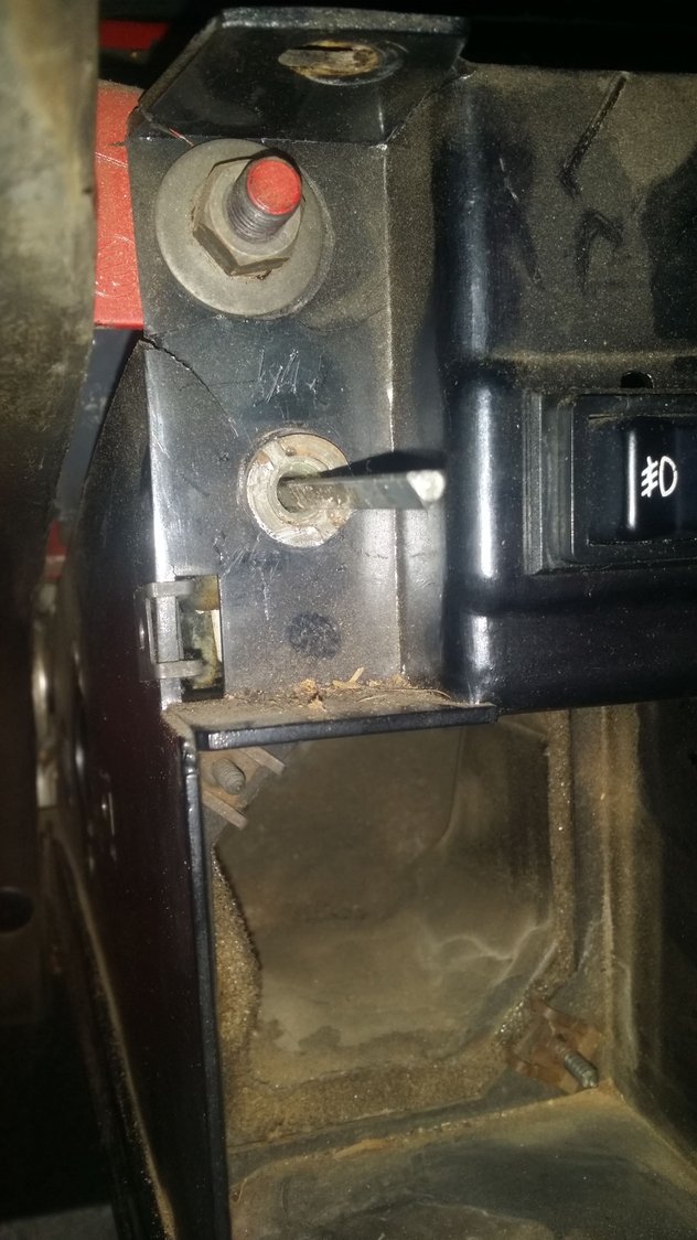

How do I get this thing off to release the headlight switch ?

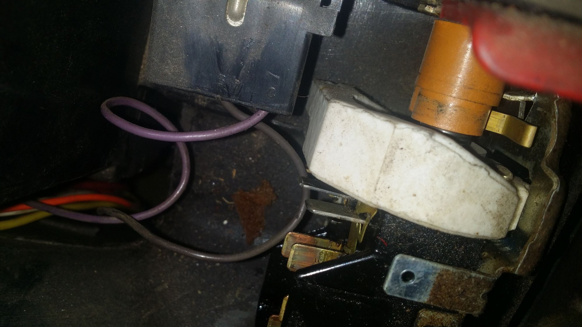

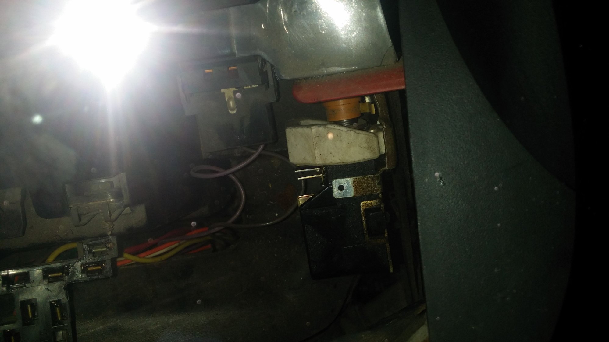

Top side view through the windshield looking down is why the bad picture quality. Sweat is probably dropping on the glass too. Literally soaked to the skin in 15 minutes. Hate the desert heat with a passion but that is another subject.

There should be a small button (metal) on the back-side of the switch, it's not very visible in the snapshot but you pull the rod gently until you feel the detent, then depress the button on the back-side and then the rod will come out and the nut will be a piece of cake after that.
The first time it can be a little challenging but after you fail a few times and then you succeed you feel "how stupid was this". You'll be fine.
Do you have the new one yet?

I used a screw driver and a hammer. Pretend it is a strange nut and tap it loose in a slot with a hammer, gingerly. Then use a pair of needle nose type pliers and then use the slots in the nut an unscrew it until it comes loose. Lube the new one. If you keep your 88 you might have to do this job again.

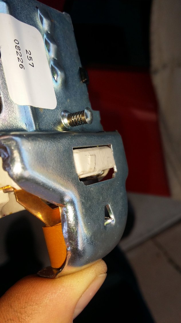

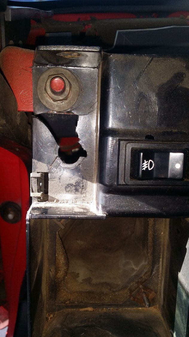

Here's the button Cliff is talking about. I examined the new one and was able to find a small chisel wedge to depress it. Came off easy the first try. <br/>
WARNING !! Don't push on this nut. Grab it with vice grips once you have it set and turn it. I did this with the part in my hand and wish I had known better. The plastic is so brittle here in Mesa AZ. I have lost many interior parts due to brittle plastic and warping.

Aside from breaking plastic and now knowing how to change the headlight switch nothing has changed. The headlights still won't come on and they stay open. My problem is somewhere else ? I have checked the fuses. In fact I checked every single fuse in the car. Could the module be the reason my lights won't come on or retract ?
