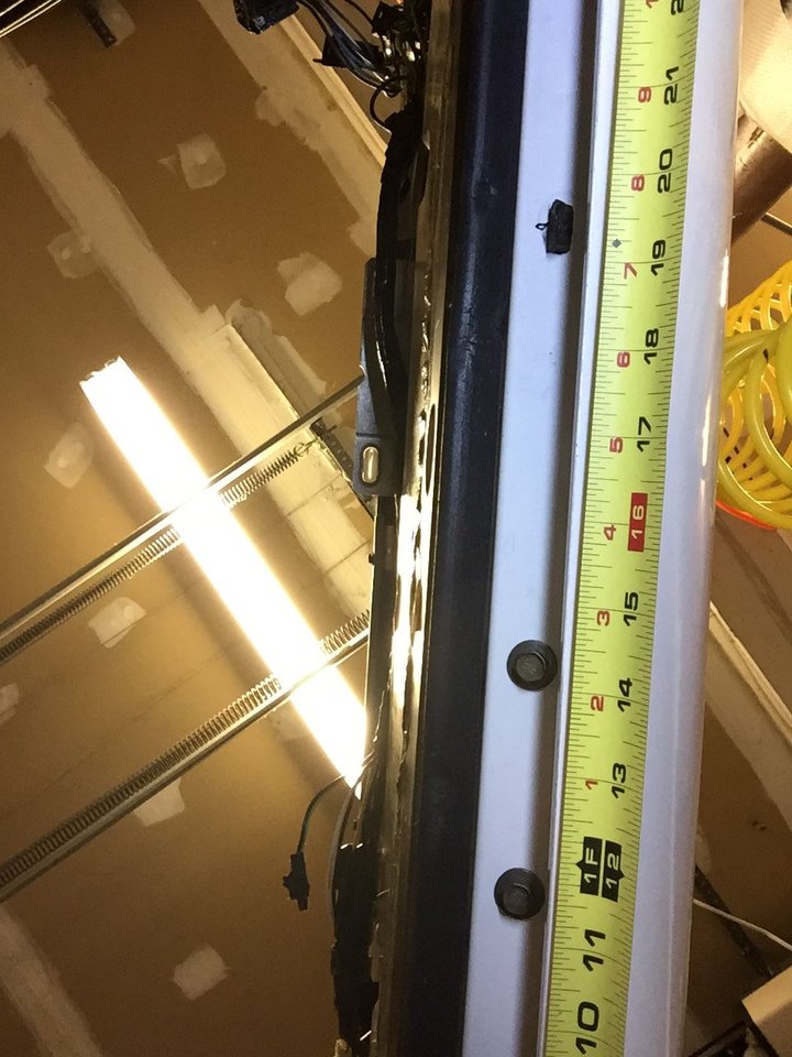

Received the new regulator today and test fit it in the door. Now I know where the two holes are supposed to be. Well not on my door.
For those who have made the upgrade please take a look at the picture and let me know if my marks are correct.
I bolted it up at the top and used a sharpie on the bottom through the threaded holes.

Originally Posted by SemperFiArms
Received the new regulator today and test fit it in the door. Now I know where the two holes are supposed to be. Well not on my door. For those who have made the upgrade please take a look at the picture and let me know if my marks are correct. I bolted it up at the top and used a sharpie on the bottom through the threaded holes.
Let me go take a couple quick measurements. Be right back..
Ok. This is what I get by holding the tape at the bottom rear corner of the door.

Thanks, I'll grab my tape and double check but that looks about right with what I marked.
Were your holes slotted or round?
Old Oct 27, 2015 | 10:43 PM
Dt86's Avatar
Dt86
Joined: Jan 2014
Posts: 4,017
Likes: 492
From: Poughkeepsie New York
Thanks, I'll grab my tape and double check but that looks about right with what I marked. Were your holes slotted or round?
Anytime. The holes are round in my door. The slotted one is for the rubber stopper.
