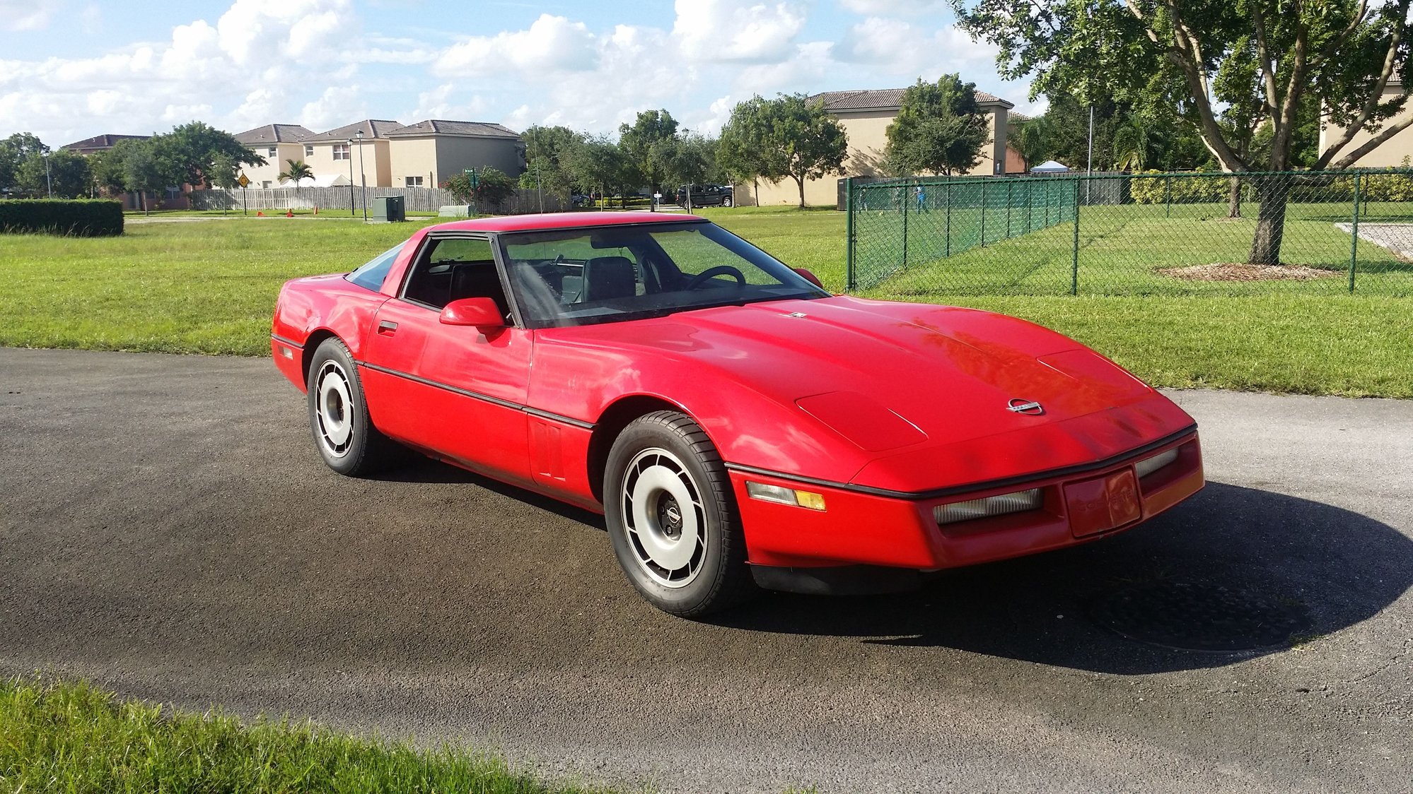

This is my 84 that I own.

nice car great to see a kid wanting something other than a rice burner!!!!!!!!
