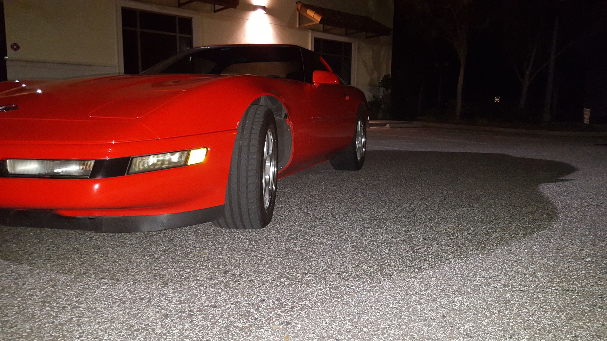

1. Not sure if I like how the wheel well gap is really narrow up top and larger on the sides. Sort of looks a little un-proportional to me, not sure. See pic:

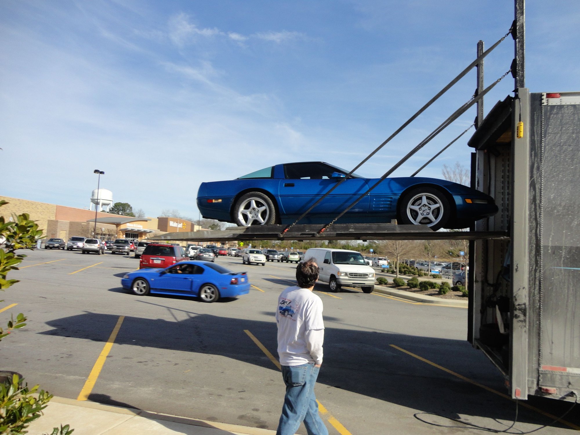

I've lowered the rear of many by about 1" with the longer bolts and it looks better and still maintained the front to rear proportions (front sightly lower) I did the front and rear both about 1" on my 95 and although it looks good I will not do a front again big pain and I do think it ended up with a harsher ride.
Just the rear with bolts.

That actually looks great. I was thinking about lowering the rear maybe 1/4-1/2" on the stock bolts to achieve a similar look with still a little rake. Does the front end feel floaty at speed? Are your ZR-1's lowered in the rear only?

Just the Blue 91 is lowered in the rear, the Yellow 93 is stock all around.

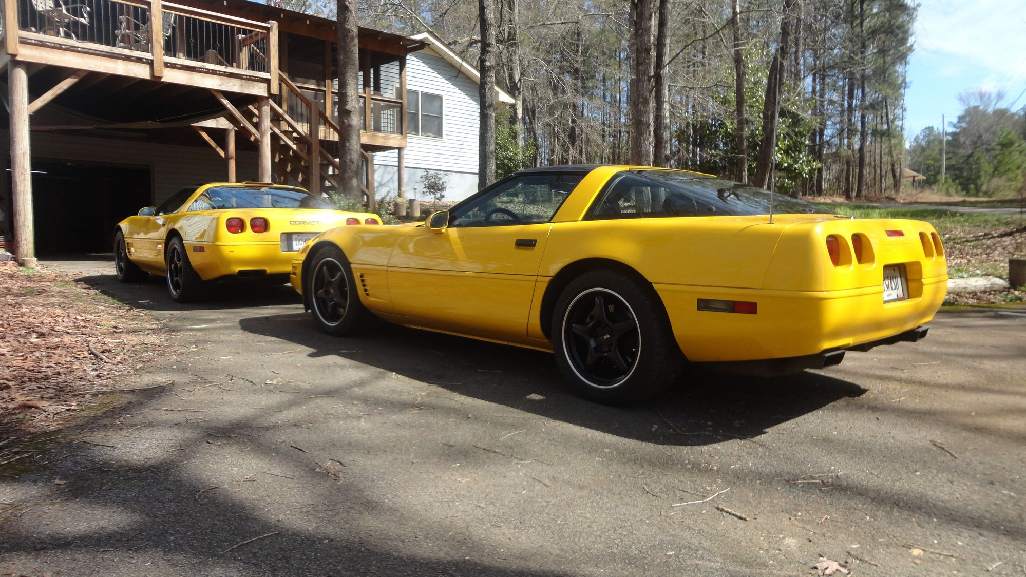

Here is the Yellow 95 LT1 that I did front and rear & the 93 stock

All of them look great. I really like what you did with the blue 91' though. Simple and effective. Might have to try that route. Messing with the front end cutting or gluing wedges doesn't seem like the most fun in the world. Especially if I end up with a more jarring ride.

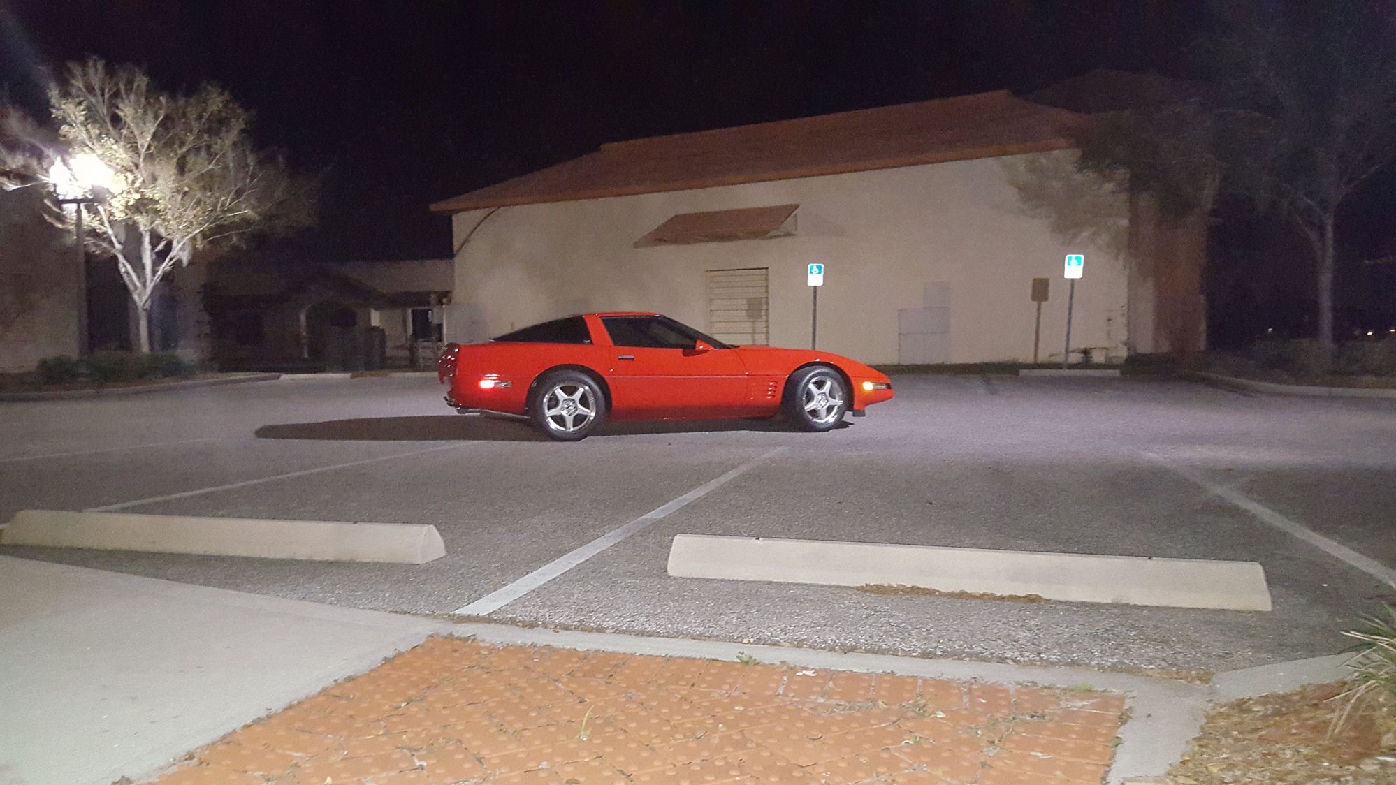

Well I went ahead and lowered the rear only approximately 3/4" with longer bolts. Think it came out pretty nice. Freshly detailed the car but dew settled on my car and made the paint look dull.

How does it feel/handle now?
