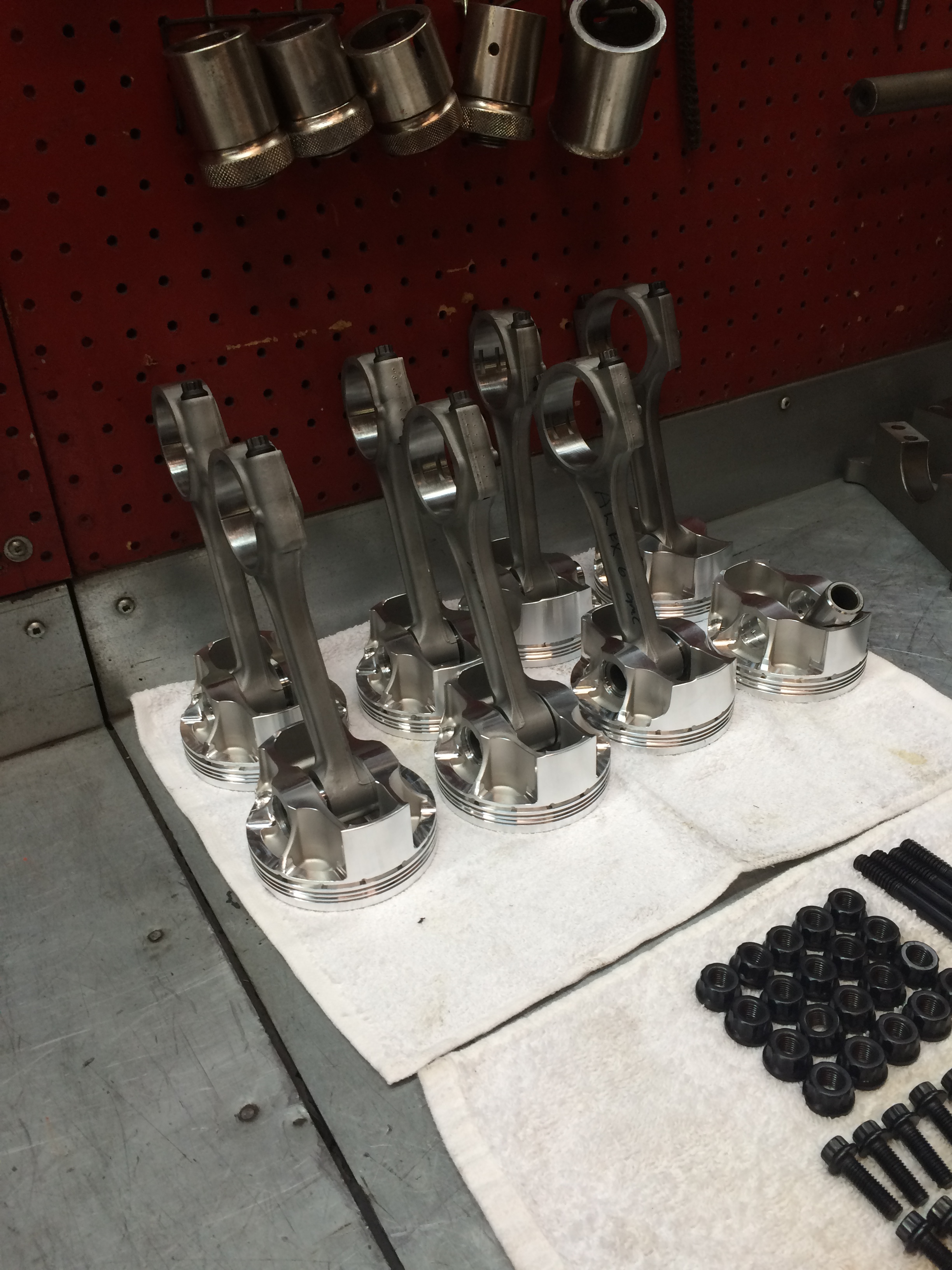

I am in the middle of a Lsa install in my 86 convertible to be ready for slalom this summer!
Parts list/Progress/cost:
Lq4 block fitted with forged pistons and rods- at machine shop currently----$5000 all funds CND.....still waiting....june 14 2016
L92 heads rebuilt-complete..roller rockers...new valves ----$1800
LSA lower bought from ebay 5000 km takeoff----$750 ported for 102 tb, isolator installed
ZL1 Lid - new -----$400
solid isolator install ----$75...done
self ported snout to match 102 mm throttlebody(ebay one)--$200..done
107962 60lb siemens injectors----$450
LSA stock rail----$350
walbro 450 in tank---$200...done
aeromotive reg and guage ----$300...done
1/2" line ran for feed ss 3/8 return..$150...done
4L80E running as is no rebuild with stage 2 shift kit(stock convertor atm)---$1500
dana 44 swap - complete---$900 minus what i sell my D36 and suspension for done dana 36 sold $700
some sort of brake upgrade unsure of which yet ---tbd.....
DRM rear suspension brackets---$300 ....done
DRM brake bias spring---$30
Adjustable camber rods ----$300...done
Poly bushings everywhere--complete--$400
6 point hoop with removable door bars---$750...in mock up phase
corbeau a4 red pair---$1300.... deal found! $700 installed!
stage 3 brian tooley racing camshaft...love that chop!...$600
fab exhaust from c5 manifold to ss l88 system including making flanges ...$150...done
battery relocation to passenger under speaker compartment with aluminum sealed lid ,vented...done
the photo with the balancer shows the 1/8" clearance between LSA
balancer and rack and pinion just enough to get a belt down there, this is with an engine positioned forward 1 inch to clear the wiper motor and rear of blower which now has also just enough clearance
hood modification...plan atm..cut hood along both sides of mini cowl peel and raise to mimmick a toledo pro 2 3/4 ...wish me luck
side note : if someone were to do this using a stock cts-v lid or ls9 lid i think it would clear the stock hood .lots of room at the rear just not at the front which is where the zl1 lid is much to tall ...1"-1.5" too tall at the front
car is close to completion still waiting on my engine which went for balancing on wednesday last week
once i get that its assembly and install time
Cant freakin wait !!
