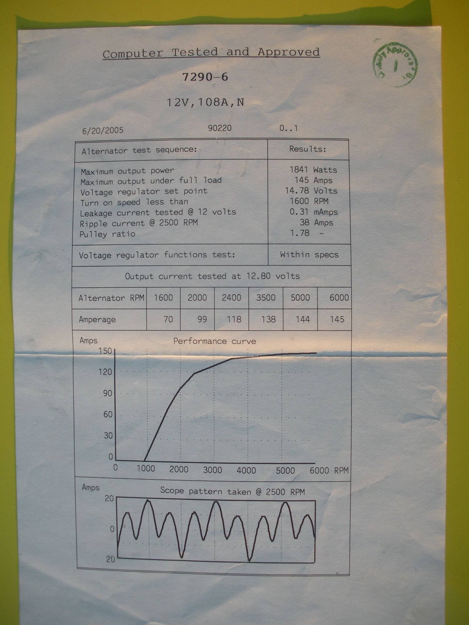

I agree. A good shop should be able to verify that the alternator is built right, and that the internal components are well matched. Here is the test report on my '84 alternator that I installed 10 years ago. This is a standard 108 A. unit, which put out a solid 145 A. @ 6,000 rpm. The bottom curve confirms that the rectifier diodes meet spec, and are well matched, which says that one diode isn't carrying excessive load, which would cause overheating and a short life.
Is there a possibility that you are charging a dead battery with your alternator? You should always use a battery charger rather than your alternator. Alternators are not intended for charging dead batteries, and that will overheat your alternator!
That was in the box with your purchase or part of a "for hire"? There are remans sold with a similar printout packaged with the product. This type of test isn't really very readily available at most "walk in" facilities.
The 7290-6 looks like it could maybe have been a test done on a specific replacement part # vs. a "carry in" for testing OR they used a typical 108A as a "spec" in the software to compare.
You are right (as usual). I purchased this from a reman facility, and upon my request, I was able to review the test specs for several alternators, and was allowed to select my favorite. They were serialized, and all had different test results.
I only provided this information as an example of what can be done, and what the test results of a good alternator should look like. It IS possible to get good remanufactured parts!
