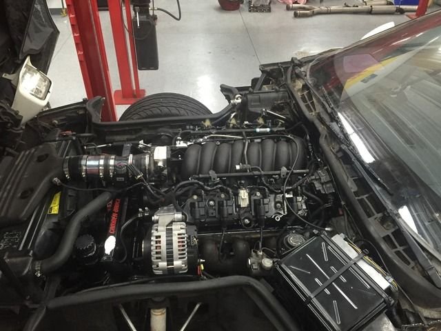

I just finished a LS swap into a 86. Used the C5 brackets, The power steering pully barely cleared, there is no was you could fit an alternator under there too. C5 stuff worked good. On the 86 you couldn't put it too far back or you couldn't access the rear exhaust bolts.

Used mount plates I found on Ebay with multiple holes. Think it moved them 1.5" fwd vs others.
Had to use C5 stock ruel rail to clear wiper motor. Aftermarket holley ones didn't fit.
Didn't touch the heater box. It's tight there though.
