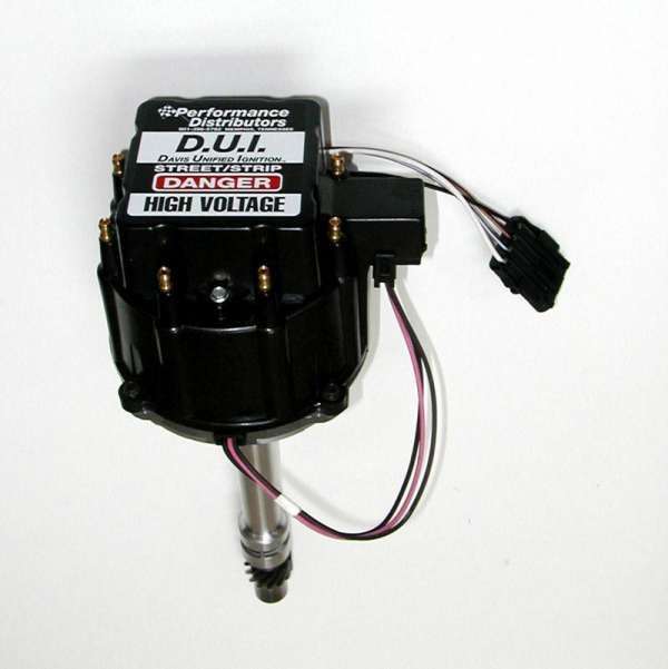

This is your distributor .You need to searcha computer controlled distributor.Your stock one is like the Davis unified HEI distributor.It

I used the DUI distributor on my '84 DD for years, a quality part if a little pricey, highly recommend it. The only issue may be the fancy dust cover, mine touched the hood when closed so used the stock cover.
