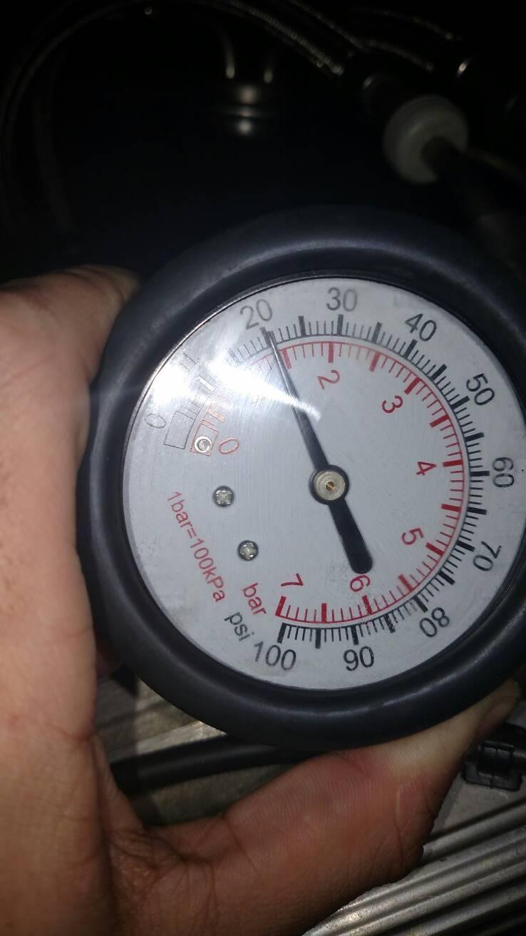

Here is the FP with the pump on but the car not running. After turning the key off pressure slowly went up to 40 lbs after 30 minutes?!?

Went up after 30 minutes never saw that one it should hit 40 right away I would change the fuel filter. Best to break it at the back release the lines under the hood and take it out the top. If the tank is full might get a bath clamp off the fuel line by the pump or remove.

Originally Posted by C7-Beast
We replaced the new ICM with another new one and the no start condition is gone. It still will stall out after it's warm. The idle will drop to 300-600 RPM then stall.
I put a FP gauge on it today and FP reads 35 lbs with the engine running. What would be my next step?
35 pounds with the engine running and the vacuum line attached to the fuel pressure regulator is within specification.
I see NO reason to change the pump or filter or pulsator at this point. What test has shown that one is needed?
The pressure went up after you shut off the engine due to heat in the fuel rail. This is normal, happens all the time. Engines get hot, so does the fuel in the rail.
You can also check for bleed down. Key on, engine off, a couple times, wait about 5 seconds between cycling key from off to on. To build pressure in the system. Note how long it take to drop the pressure any amount.
That picture you took? How was the pump running with the engine off? Did you jump the relay? Or did you snap this with key on, engine off as someone else turned the key to ON? The pump only runs for 2 seconds then shuts off if the ECM does not see engine RPM.
***You replaced the ICM and the no start is gone but stalls after 30 mins. of running. Did the car immediately restart? If it did not, what are you missing.***

Really he turns the pump on without starting it goes to 20 then turns the key off after a while it goes to 40. Sure sounds like a pluged filter to me!!!!!!!!! JMO But I have been wrong before.

If you read my post I asked him how he took that pic. If the key was on, the pump only runs for 2 seconds. Unless he had someone cycle the key and he snapped the pic when the pump was actually running OR jumped the relay that pressure reading may not be valid.
His engine running vac. line on the fuel pressure regulator and the 35PSI is a much more valid test as the car is RUNNING.
At this point if the car runs and then dies after X amount of time. That completely changes my diagnostic thought process.
I'm no longer really worried about fuel pressure. I suppose its possible for the pump to shut off after running for a period of time but unlikely.
I don't understand the confusion, I thought my post was pretty clear.
Difference might be in philosophy, I'm not real quick to suggest parts when more extensive testing is in order. I don't make a call until I have a complete picture. I don't think we are anywhere close to that at this point. Given the car starts runs and then after a time stalls. I've asked the OP some more questions to get more info on that condition. Lets wait to get those answers.

I agree with that but he shows where the pump was running with the key on not running and only 20 pounds. Then turned the key off and it slowly went to 40 pounds. I have never seen this but believe a very clogged fuel filter could do this.
No confusion or throwing parts at it. JMO and maintenance.

When running, the gauge read 35 lbs. I snapped the picture while the key was on but he engine was not running.
My son turned the key to the "on" position and that is when I saw 20 lbs. We repeated turning the key on and off several times. Leaving the gauge connected, and the key off, the pressure went up to 40 lbs after 30 minutes.
Before we replaced all the electrical components the car was hard to start and once hot, the idle would drop and it would stall and would not restart for 30 minutes or so.
So once we replaced the electrical components, and replaced 2 ICM's, the car is no longer hard to start and now restarts fine even when warm.
Everything replaced so far was needed as it was all original and the car has 75,000 miles on it. It was also father son bonding. We were not just throwing parts it at. We are fixing problems so he can have a safe dependable car. There were at least 10 things wrong with this car and we have whittled it down to this last issue.
Thanks for all the help.
