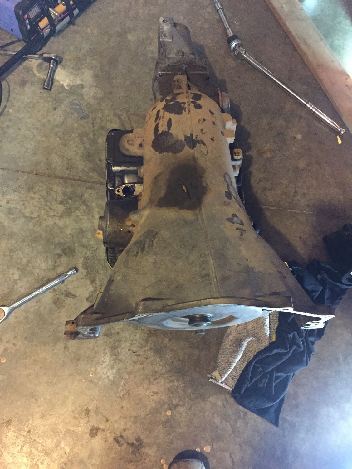

got every bolt undone and tranny is on the pins propped up under the car. will lower tomorrow and see if it flywheel. if not, ill have a new torque converter the next day.
what do u do with the trans dip stick? just pull it out and let hang?

If you're just sliding the tranny down and back, you will have to pull the dipstick tube out of the tranny. You can just let it hang there. Don't forget to push it in when you are ready to bolt the tranny back in place. Good luck.

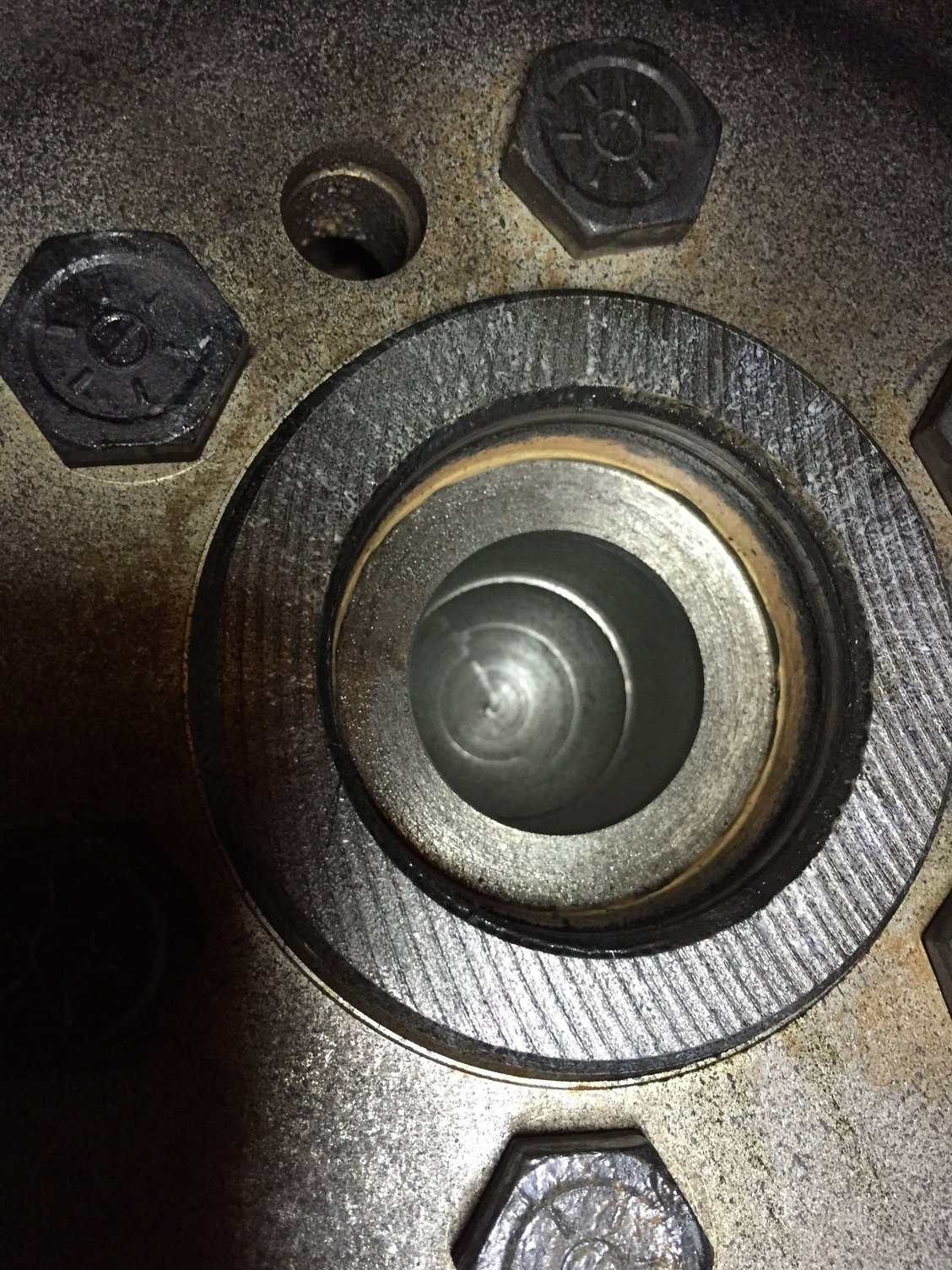

Default the flywheel lools just fine. new actually.
and i think i see a date of 10.11.9 with some initals above it. is this where a rebuild shop woud put a date in yellow pen?

do u guys see anything of note in the pics above?
the vids of the noise is posted up thread. the third vid shows that the noise went away when the tc was unbolted from the flywheel. i was hoping to find a cracked flywheel. no dice.

For one, its actually called a flexplate, but no big deal. I have had them crack on me before, one time completely around the center bolt section. 9 times out of ten its around the mounting point at the crank. Your flexplate looks fine in that area, however 2 of your flexplate mounting holes to the torque converter look oblong. If I am correct, I would replace it. I listen to the video you had underneath the car with the converter still bolted up, and I can hear a clanking sound within the noise. I am not saying for sure that is your problem, but its something to look at.

It does look like two of the bolt holes are oblong. A couple loose bolts could definitely cause that noise also

The only thing I saw was the oval bolt holes for the torque converter bolts.
I would replace the flexplate for that reason alone.
Do you hear any noise when you rotate the torque converter by hand ??? You might want to drain the fluid from the pan and run a magnet through the fluid. If the pump in the trans was self destructing - I would expect to see more than a little metal in the fluid.
Exactly, one of the holes is fine and even if all three bolts felt like they were tight,they could still be slightly moving. the torque of the engine can make that happen if the bolt is allowed to go back and forth.
No matter which path you take replace that flexplate.

I guess i will replace it. ? looks brand new to me and the bolt holes appear to have been machined that way not ovalized. is it possible that this is an incorrect flywheel (i will look for a part number stamped). all bolts were tight for sure.
regardless, the torque converter is seized onto the input shaft. im committed to swapping it now.
I myself have never seen a flexplate with oblong holes, but I have not seen them all so who knows. Just incase you should replace it. If you go and buy one and it has oblong holes, please post a pic.

op here, just to clise this thread off, i dropped it, didnt use the pin idea. was just as easy to drop it. cheers all.
