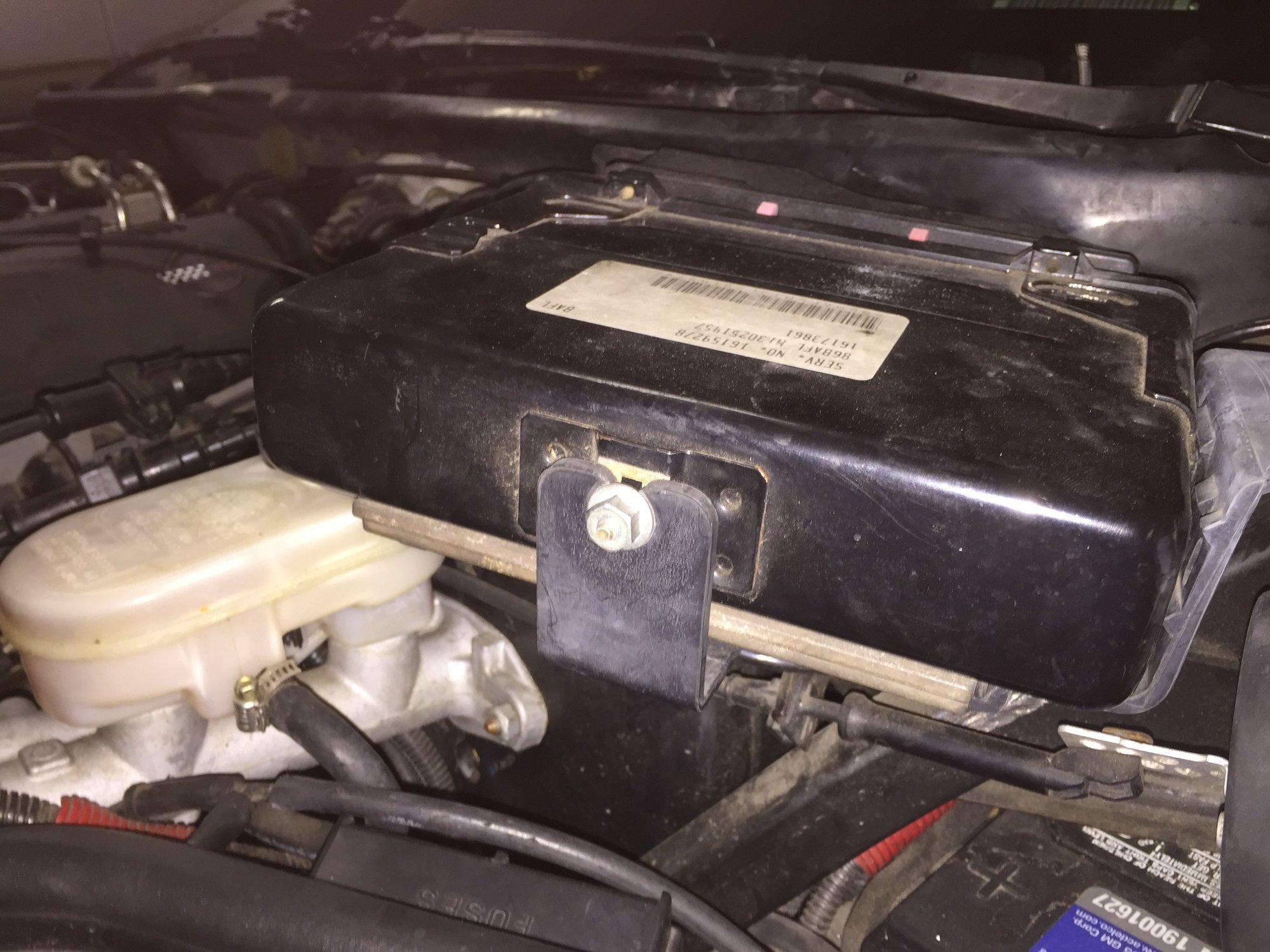

I need to replace a broken "bolt" on the bracket that holds the ECM, on my 1993 LT1.
The "bolt" is actually a U shaped clip with a half inch long bolt / stud, which accepts a 10mm nut. There are three of these that secure the ECM.

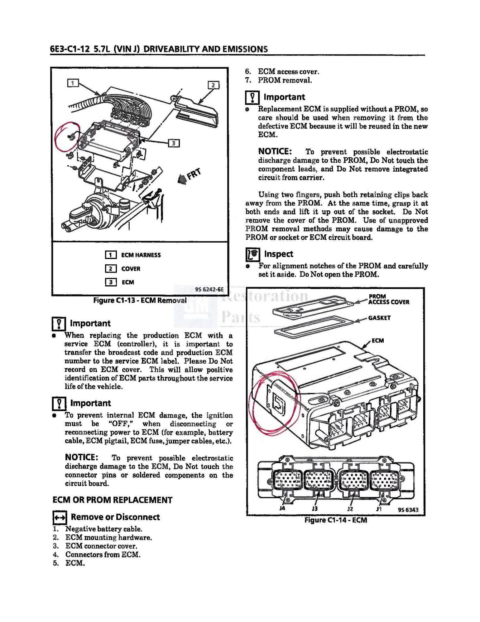

I can find plenty of U nuts (the female version of this item), but cannot find the needed male version. I also cannot find a GM part number in the FSM.
A page from the FSM is provided below with the item circled in red. I also provide photos and close ups.
Can anyone provide a part number, or a suggestion for where to find these?

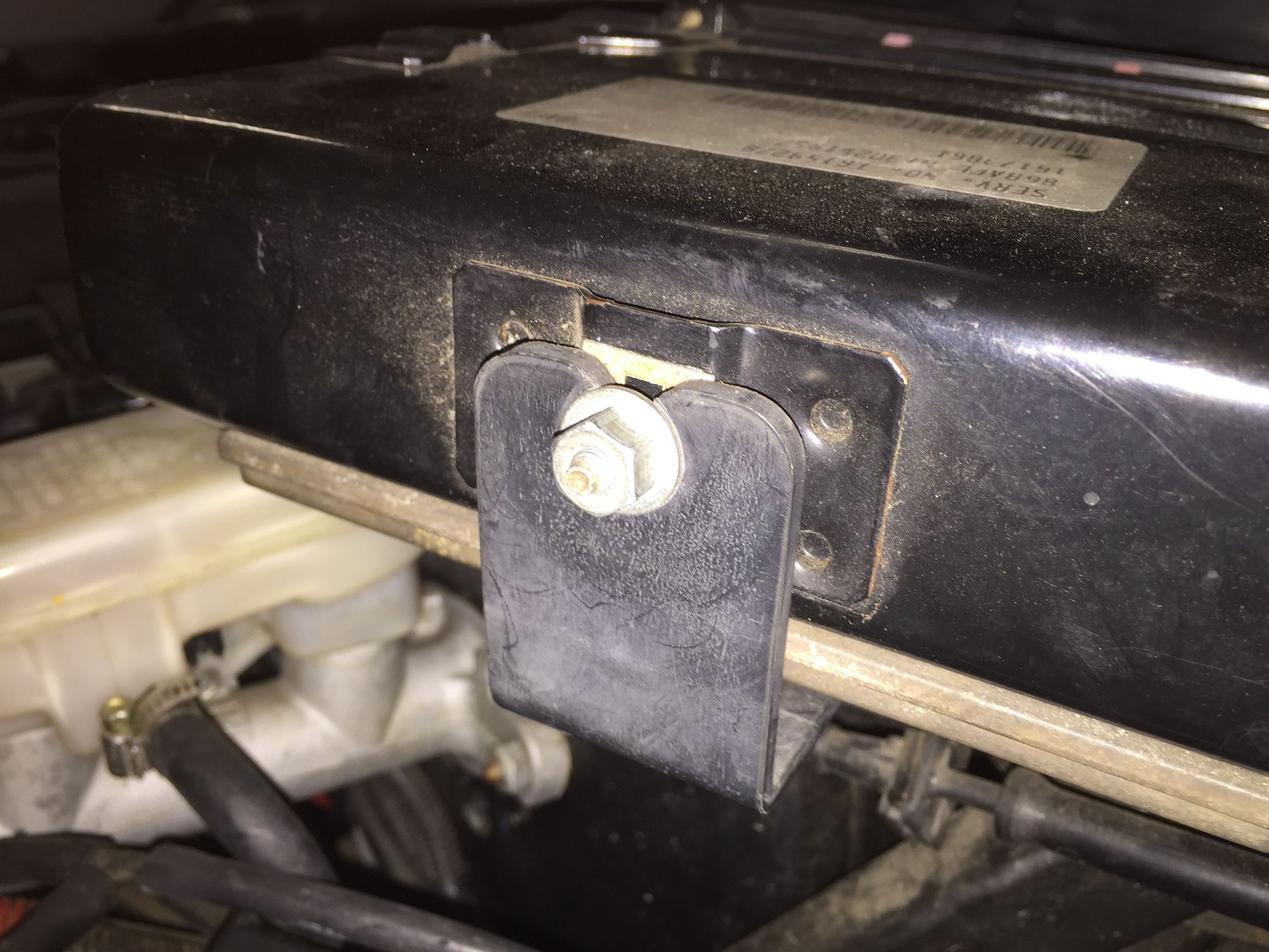

Close up with nut attached
Nut attached
Close up with nut removed, and ECM tilted up from normal position.
Typical locations circled in red

The GM # for the hardware is 12337892 and can be purchased nearly everywhere even Amazon. If there's a salvage yard/JY in the area it's used on nearly all ECM brackets, radios and other electronic devices.
The thread is actually M5 X .8
I would think still available and on many dealers shelves.
