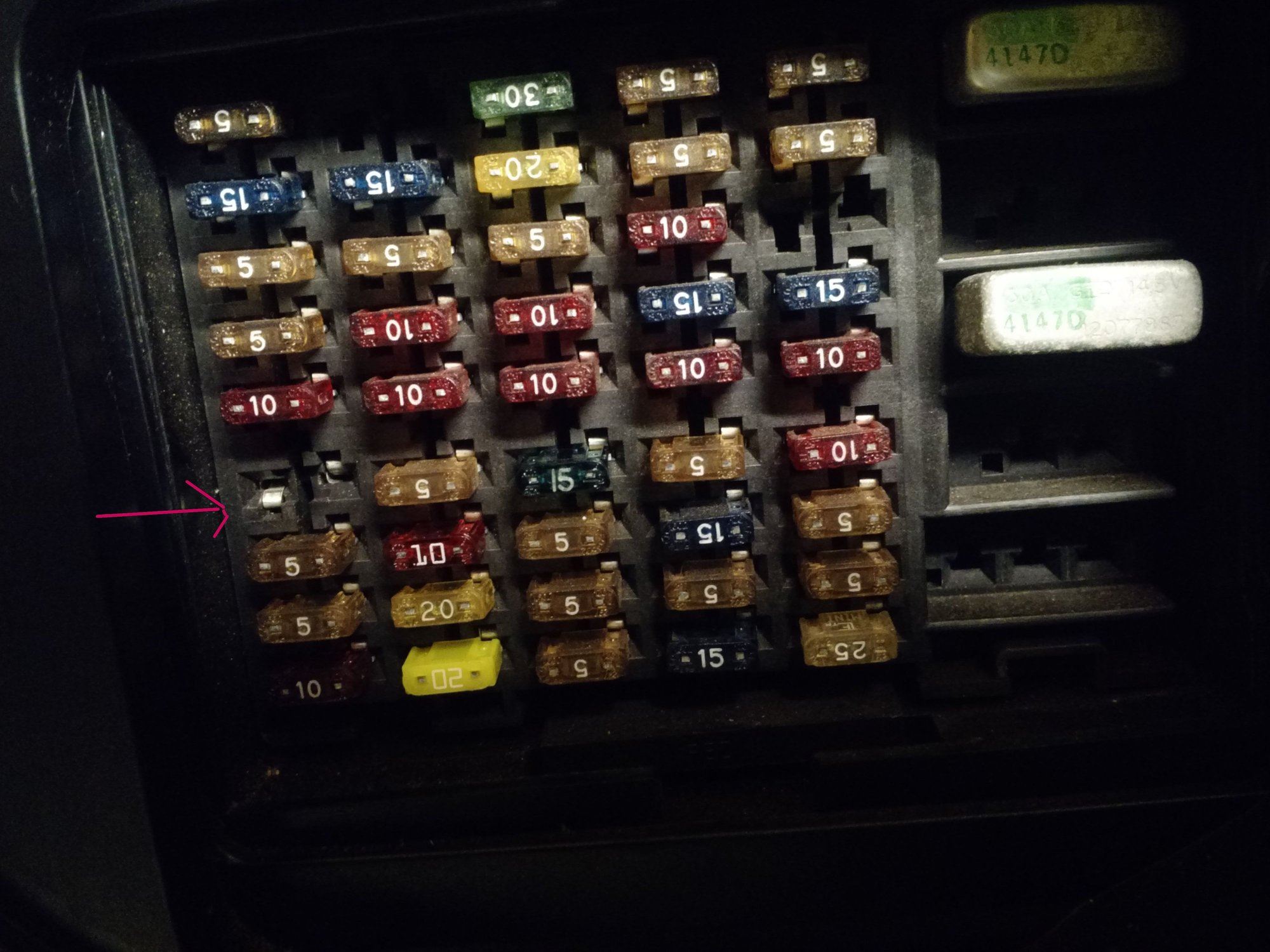

If you don't have fobs anyway, pull fuse #26 in the passenger side fuse box and you'll be good to go. It's a 5 amp and here's a picture where I pulled it out of mine.
