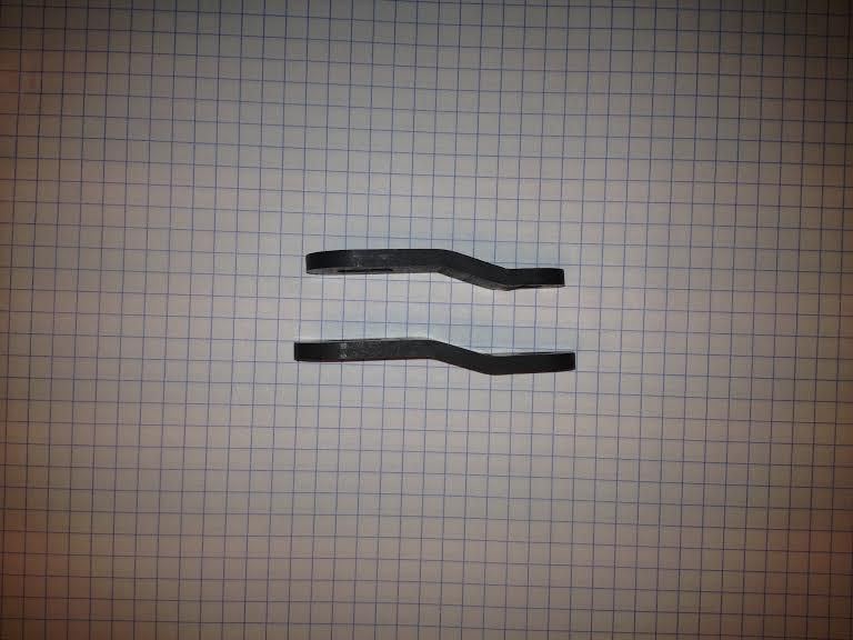

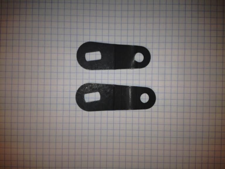

Default Pics of short shift kit
Thanks Carl! carls1957 really came through and sent me the short shift kit. (Last one on the planet?) It was apparently made in 2005 if that tells you anything.
I've attached a couple of pics on 1/4" graph paper so anyone who wants to replicate them might be able to. If anyone needs any additional pics or measurements, let me know fairly soon before I get a wild hair and install these!
