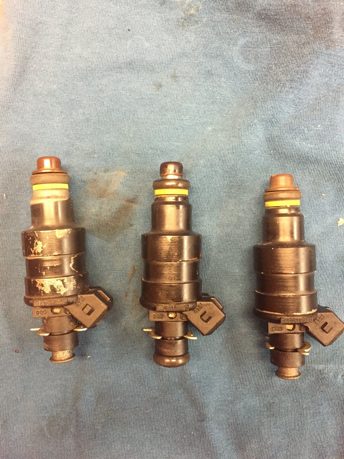

hello guys, I'm just putting my fuel rail back on after doing my head gasket job and I'm cleaning up my injectors. One out of eight has a broken rim on the brown tip of the injector.
I did not have any fuel leaking not did i have pressure leakdown, but I was chasing down a rich condition. That led me to discovering a compromise head gasket at number seven.
has anybody else seen this? With this affect performance? Obviously the injectors are designed to have a rim around the tip.
thanks for your help, my plan this evening was to reinstall the fuel rail and I'm kind of stalled out now

I would not risk it. Where did the missing piece end up?

It looks like the missing "Hat Brim" was used as an Oring support, or one side of the Oring Groove. If the Oring seals properly without it then not a big deal, otherwise it may be a source for a vacuum leak.
I personally would buy a single injector and replace it.

Why? Just buy the hat and be done with it. That or send it somewhere like RC Engineering or FIC to have them all cleaned and tested. Or if they are Multecs, get a rebuilt set and put these where they belong. The recycle bin.

My money, if I were a betting man, is on the hat breaking off, falling into the runner and into the cylinder, melted and evaporated and in the atmosphere.

I wouldn't throw good money after bad. Multec injectors have coils that are cooled by the fuel. Ethanol eats at the coils. It is very difficult to get pure gas today without ethanol so unless you can do just that, you have to figure that you are getting gas and ethanol. So, why rehab an injector set that is that vulnerable? A rehab costs $22 X 8 or $176. For $190 you can get a reman set so why bother?

from the OP's pics, the injectors are first generation bosch, and a fairly good injector. I am not aware of any multec injector having a pintle cap. on an upgrade set from FIC (boschIII's), unless the OP has budget considerations here. since VikingTrad3r is from Canada, and since the US/Canadian dollar exchange rate presently sucks, i'd consider home servicing my originals.
if the OP is interested in a new service kit for his originals -
http://www.ebay.com/itm/V8-Fuel-Inje...0bIhkg&vxp=mtr
I have cleaned injectors in the past. fairly easy for the home shop - plenty of youtube videos showing the procedure.
BTW, I read that multec injectors manufactured after 1995 did not have the ethanol gas/coil issue.
