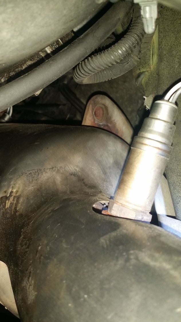

Crawled under my car and took a look. Lo and behold, the right side brace is not there. But I don't see where access to either bolt is difficult. I wouldn't think there is that much difference between my 95 M6 and your automatic. I will post up a pic of what I have.
Brace is gone, but can see where the bolt goes in.

I think that is the same bolt that I dealt with when removing my Cats to install my ARH headers/Cats, it is up by the bellhousing with no way to get any tool up there.
The bolt seems to be accessed by removing the transmission! I cut the bracket instead.
This probably does not help the OP much but the ARH Cats did not use that mounting point which is why I cut the bracket.

For some reason, GM put one brace to transmission bolt in a spot that requires either tilting the transmission or drilling an access hole in the floor pan to remove. The OP indicated this was the bracket to cat bolt. If he can get that out, there will be no need to remove the bracket.

Yes indeed that is the hole for the bolt but in that picture you have a world of room more than me. I cannot even see the bolt from the angle you used and I don't fancy removing the trans or cutting a hole in the floor. How in the world did you cut that bracket with the cat attached. Still crossing fingers the new swivel will do the trick
