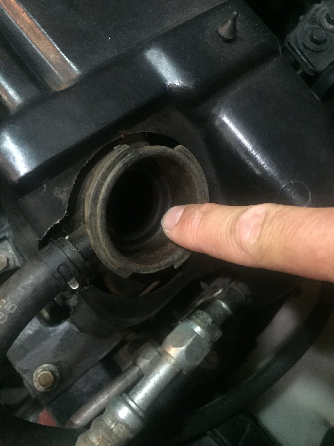

Old Apr 24, 2016 | 12:14 PM
  #71
VikingTrad3r's Avatar
VikingTrad3r
Oil Producer
Joined: Apr 2014
Posts: 9,372
Likes: 2,736
Default check these areas.
see notes below in images.
check this connection for cracks that would draw in air during the depressurization (drawing fluid back in from overflow) phase. <br ><br >
Originally Posted by mlm0
Did not remove t-stat. Thanks for info
if the bigger, top, seal is compreimised or if the cap is not tight enough on the neck, the seal will allow air in at the cap. <br ><br > check the rad housing at the neck of the cap between those two seals on the cap. it could allow sucking in there as well. <br ><br >

Do you have to replace radiator if old or new cap is not fitting tightly or is there something else you can do. Also how can you check before spending money on new radiator
no u dont. somewhere on the forum i posted pictures of exactly what i did to fix my new stant rad cap so it is nice and tight. ill see if i can find them. cant remember if it was a devited thread or within some of my monster threads.
