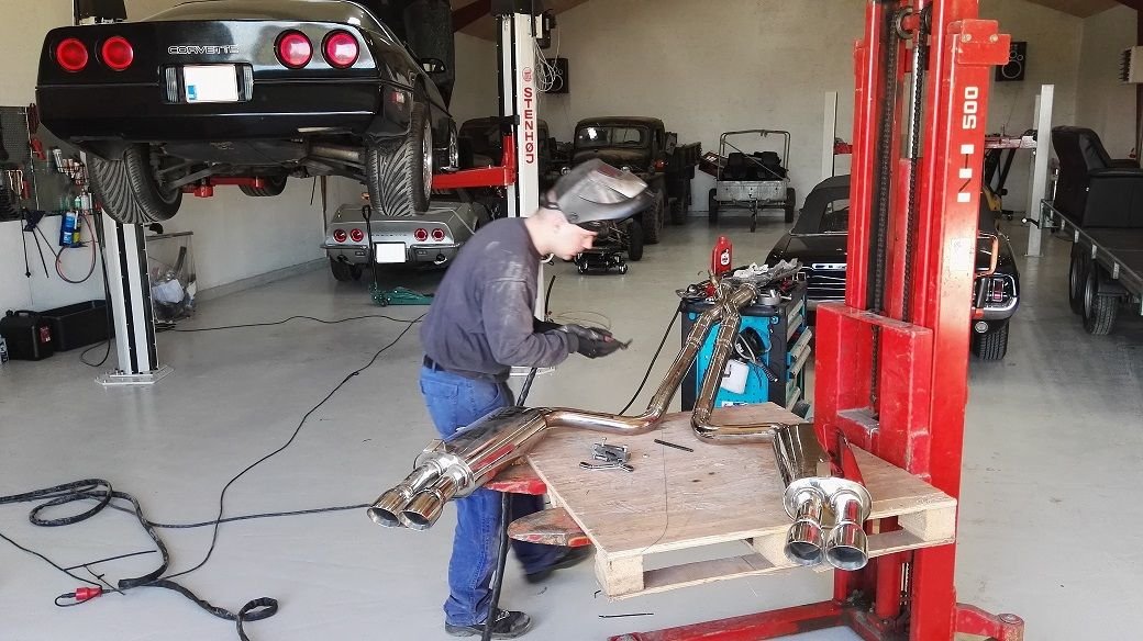

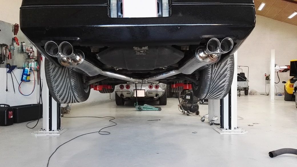

I finally got around to install my OBX exhaust on my 1987 vette.
This exhaust is absolutely not plug'n'play. It was simply not possible to install it without major modification, with the help of a friend (expert welder) we used about 8 hours on cutting, testfitting and tig welding it back together just to get a decent look...
It would have been better if they didnt assemble it and just supplied the bends and pipes...
No space for these...

Well, I was prepared for that, but not to cut up almost every weld. We didnt remove the tips from the mufflers but almost everything else.
You probably get what you pay for
I've only rev'd it a few times, so don't really know how it sounds yet (still needs a bit engine work). Idle and upto 2000 rpm does sound better than the muffler eliminators I had on before.

Looks killer, now that it's done! Sounds like you have to be a DIY'er to exploit the "value" that the OBX system offers.

I bought this exhaust about 2-3 years ago so it may very well have been changed. Everything looked like it was for the L98, just assembled with wrong angles. For example, when the left muffler was placed so the tips was as in the pictures, the tube from the muffler going to the engine, would be off by 30 degree. It's not the LT version.

Well, the hours included joking, eating, enjoying the good weather and welding the assembly into three parts for easy removal and reinstallation, so it could probably be done quicker. As other have said, it might be a hit or miss with these products depending on your luck, so it might not take as much work :-)

Nice pics and information.....
I believe it has been documented on here, I know at least once about the fit/finish/installation issues related to the OBX system. Great price/terrible fitment issues. However, folks are happy when they are FINALLY done with help from a professional to get them right-basically modifying the exhaust like you point out with new welds.......
Looks great-I assume they are stainless, so I guess the price even after paying for help is worth it....

Didnt cost me more than a bottle of argon gas, don't know how much you pay for reworking something like this in the US :-) But just don't buy this exhaust and expect an easy install, if it's as bad as mine.

Looks good what kind of tires are those.

If I remember correct, its Vredestein Ultrac Sessanta 315/35r17

Having friends that can weld stainless=priceless Nice work
