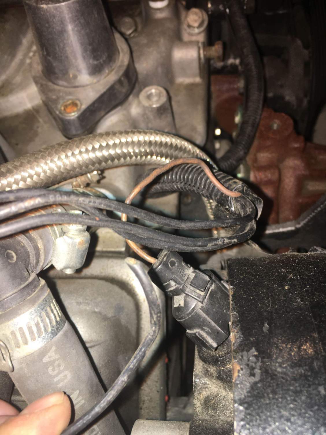

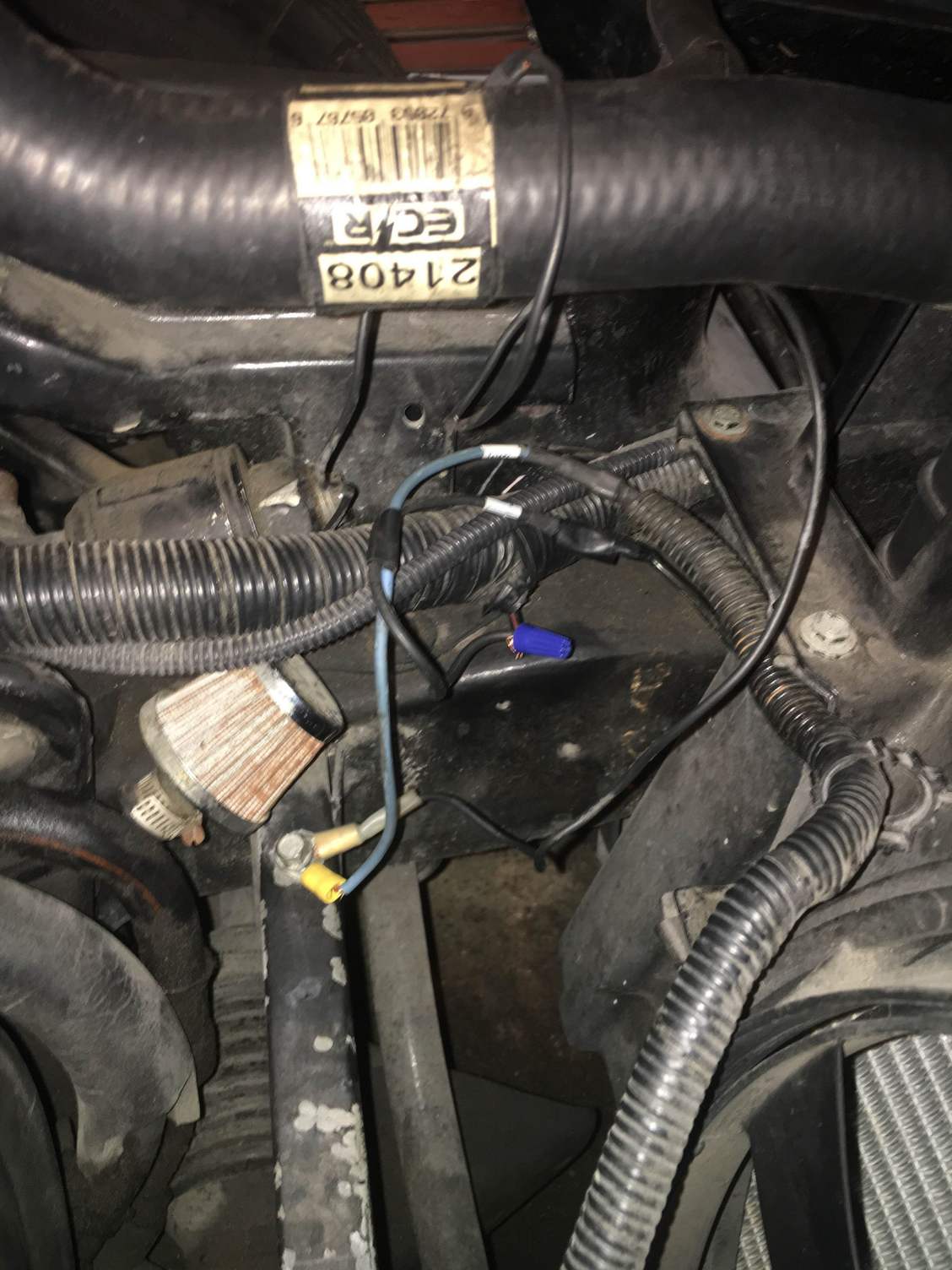

When the car is cold remove the radidtor car then turn it on and just let it run. When the thermostat opens youll know it the water will start moving around. See if you hear the fans kick on. Sounds like somoene by passed the relay/switch that oughta be fixed, un bubba ing your car will bring more enjoyment. Is the plug with wires to your AC compressor fully pushed in?
The car is definitely bubbaed... So I attached two pics of the disaster I have going on with the fan... One you will see the condenser and attached to it is only the red wire and there is a big balled up black wire which is disconnected.... not sure what is up with that or what it is/was for. The second picture you will see two wires grounded to the metal...the black one is what keeps the fan going. I tried to figure out how to get the fan hooked up normally but could figure out what wire went where and all of that.
Also, so you say to take cap off and let it run and I will hear fans.. I assume you mean internal fans? like not the big one? sorry.... this is all foreign to me, wish I knew more.
