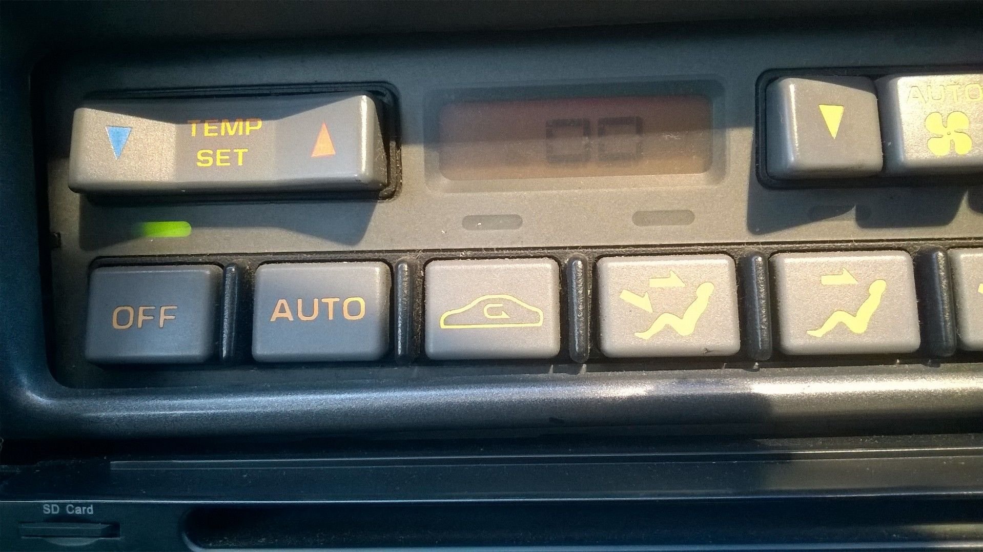

Some one on here may be able to help me with this problem
the light something flashes above the off button. But there are no codes displayed on the control readout the a/c was recharged in Nov 14 still working but does not seem to blow out as cold as it did

You've put the control in the DIAGNOSTICS MODE? You didn't mention year and it may not be relevant but could certainly help. Do you get perhaps a SOLID BAR?

yes by holding down the fan speed buttons get the 00 up then pressing the auto button that's what I meant by(But there are no codes displayed on the control readout the a/c)

Hi Sorry my C4 is a 1990 is a uk import from new not sure what you mean solid bar I can
access other parameters that are available

Is the system still R12? You mention a performance issue so I'd think you have that checked. Why no codes displayed? No idea BUT perhaps if you remove power to the system the C68 panel will RESET and then display codes. The best confirmed RESET would of course be removing a battery cable and reset ALL.
I didn't look at an FSM to see which fuse might reset it but if you have one that might be the next logical move. The "solid bar" is a possibility with a later C4 C68 panel and NOT a '90.

On '89 and earlier cars you can remove the CTSY/CLK fuse. I don't know what that fuse is called in 1990 and later cars. It removes power from the memory in the HVAC controller and it has to recalibrate and relearn. Note that the temperature setting will default to 75°, which is a good way to verify that the reset worked.

I removed the CTSY/CLK fuse it showed -- for about 15/20 sec is this normal after reset (removing the CTSY/CLK fuse)
and now it has recalibrate and relearn the temperature is show 75°, as you said which is a good way to verify that the reset worked but the light is still flashing I am going to get them to check the system for me today thanks everyone for there help and advise

I watched your video of FB and notice that everything appears to function normally and only after pressing the 'Off' button do you get the flashing light. According to the Electrical Diagnosis Service Manual it states the following.
"If the Heating and A/C System detects a fault in one of the system components, it will be indicated by a flashing MODE Indicator when the Ignition Switch is first turned "ON."
So if this light only starts flashes after you run though the function this would be the reason you are not getting any codes and that it is something else. I would consider taking the control head apart and cleaning the contacts as show in the video I posted.

I believe that since the C68 panel relies on information supplied to the programmer from the CCM and the external sensors you maybe just do the "first evaluation" check mentioned in the FSM. I don't believe I'd go first to dis-assembly of anything.
If the there's a system situation I'd think at some point the "results" would be something other than the "expected results" the procedure mentions.
The "first evaluation check" is covered in the 8A-62
I would tear apart "NOTHING" first!
