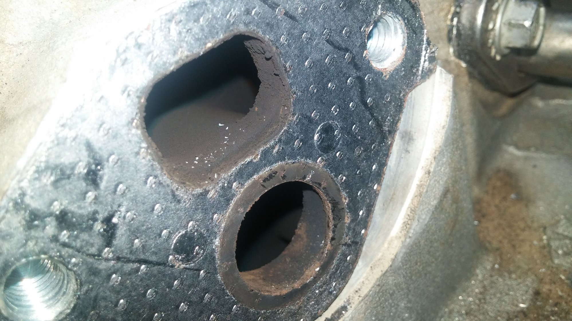

Took off the EGR. If I pull it all the way back, and put my finger on the vacuum nipple, it doesn't hold. Does the intake side look dirty?
The EGR connector does give me power in terminal A.

there is nothing obvious. If you have vacuum source see if it will open
