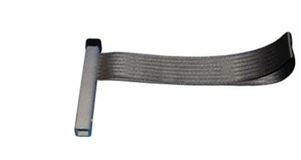

Originally Posted by CNJ Surveyor
Thanks for all the suggestions. I stopped by a Walmart last Friday and picked up the tool below. It worked perfectly, crushed the bottom of the filter and it spun off after some convincing. Happy motoring since!

Surface area is your friend when it comes to stubborn oil filters. Use a strap wrench and a cup style at the same time, you'll need a helper most likely, but the filter wont crush. The screwdriver deal take too much time and you can still not end up getting it off and be left with the base staring at you.

Strap wrenches work great!
