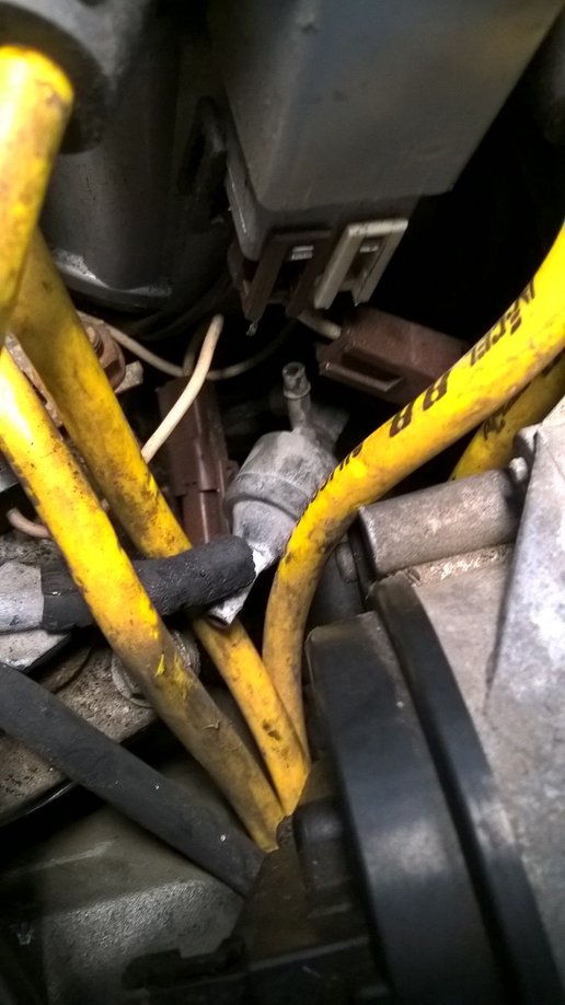

Look at the vacuum check valve (next to the distributor on the driver's side):
They're pretty cheap so you might want to just replace it.

Good call Cliff. Here is what I found. Guess I knocked them off when I was replacing the value cover gaskets.
