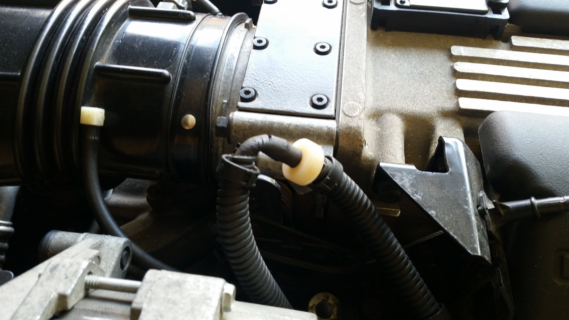

Default Cracked Hose
What is this hose and why does it seem to be too long and have to bend at 90 degrees or so?
Very bad hose
Old Aug 6, 2016 | 07:08 PM
SELLC's Avatar
SELLC
Joined: Jul 2016
Posts: 222
Likes: 11
From: Plymouth MI
Very bad hose
It appears to be your distributor vent hose, but I cant tell where it's going so don't quote me on that.
It also appears to be very close to your throttle, might want to do something about that when you fix the hose.

That could be as the PO said he added an MSD vented Opti.
