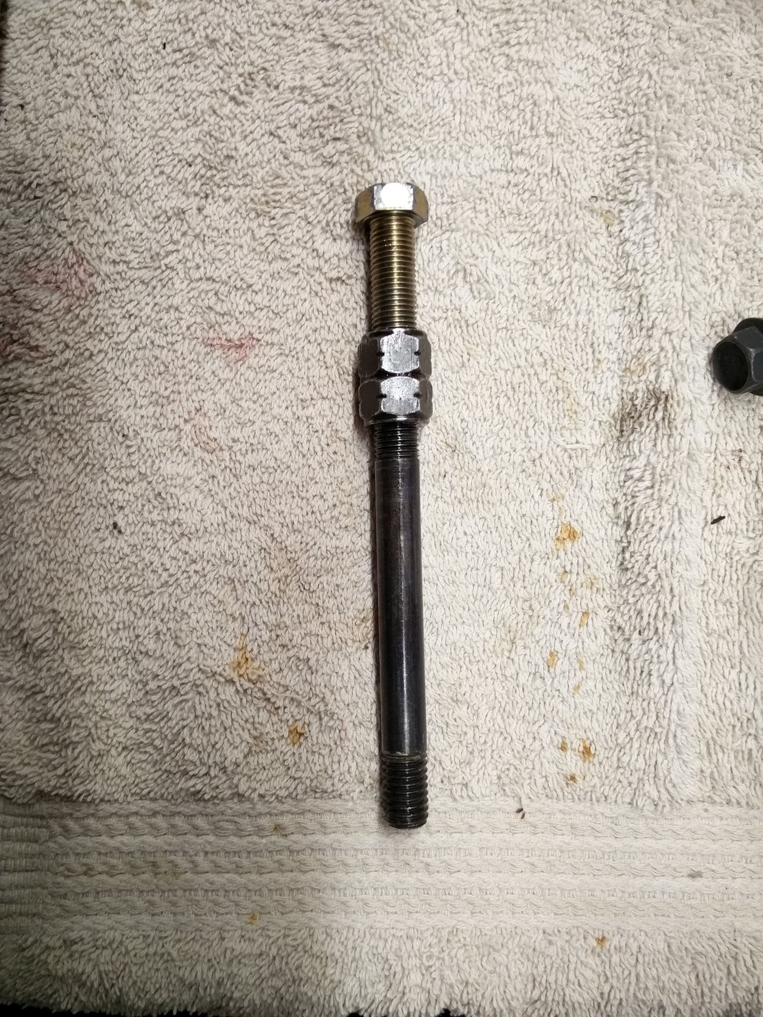

Alright guys, I got it. Thanks for all your help. I was able to put two (old) nuts on, hold the bottom nut with needlenose pliers so I could tighten them together, and then put a socket on the top one. So basically the usual trick except that I unscrewed it from the top nut instead of the bottom one. Then to put them back on I threaded a nut halfway onto the stud, threaded a bolt into the half sticking off, and put a socket on the bolt. When the stud bottomed out the nut and bolt loosened before the stud did. I didn't have to turn the wrench nearly hard enough to be worried about damaging the threads.

I had to put red Loctite on a nut, screw it on finger tight, screw on another Loctited nut snug on top of it (which left about half the nut hanging off the stud) and then thread a loctited bolt tight into the top nut. Basically the bottom two nuts are lightly locked together, then the bolt locks the top nut in place by putting tension on its threads, like double nutting but with two bolts instead of two nuts. Also, it was possible to snug the top bolt up just enough that its head aligned with the top nut's head, so I could get a deep socket over the both of them. Let the Loctite set up for an hour, then slowly backed out the stud. It's ridiculous and complicated, but it worked when nothing else would.
