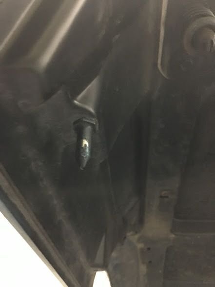

I can get you the pictures of the pins we are referring to, I will be working on the car tomorrow night I hope

Pins.. Driver side pin and receiver
You know, I never really noticed them on my car! Is that the way it is on the 1996's too? I'll have to look for them the next time my hood is open. Thanks for the tip!

yes I believe 96 has them as well
