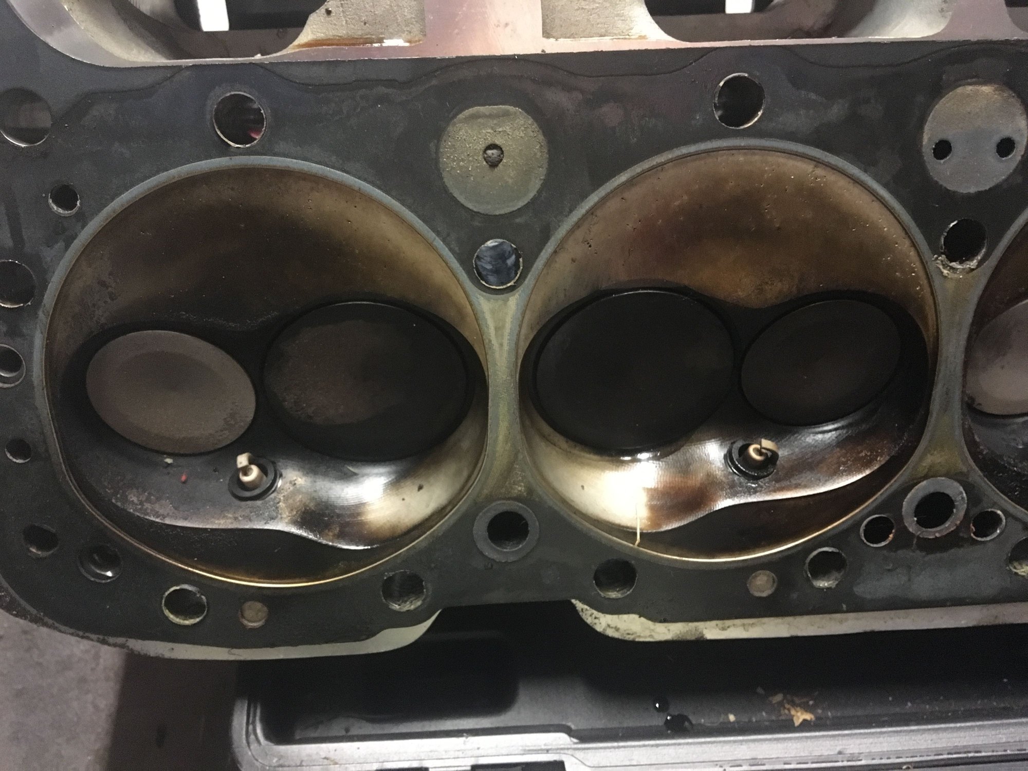

Pulled apart down to the passenger side block. Cylinder looks great. Head gasket wasn't leaking. The exhaust valve on cyl 4 was a tan color, unlike all other cylinders on that side which were a golden white color. I did not pull the drivers side head.
I stil, have to pull the oil pan. Then I'll pull the piston but it looks no different than the others but obv I can't see the sides of it.
Rest of the motor so far looks just as it should for a well tuned 383 with 12 on it. All cross hatch still visible, etc.
One thing I did notice on cyl 4 head was a clean spot on the 6 o clock part of the head. This to me means an injector was leaky and was dripping fuel. I'm thinking that's what caused a ring failure but I'll know more tomorrow.
What do you guys think??? Main bearings will tell me a lot and I can see what's in the pan. I'm praying for a rering and injector rebuild and run it.

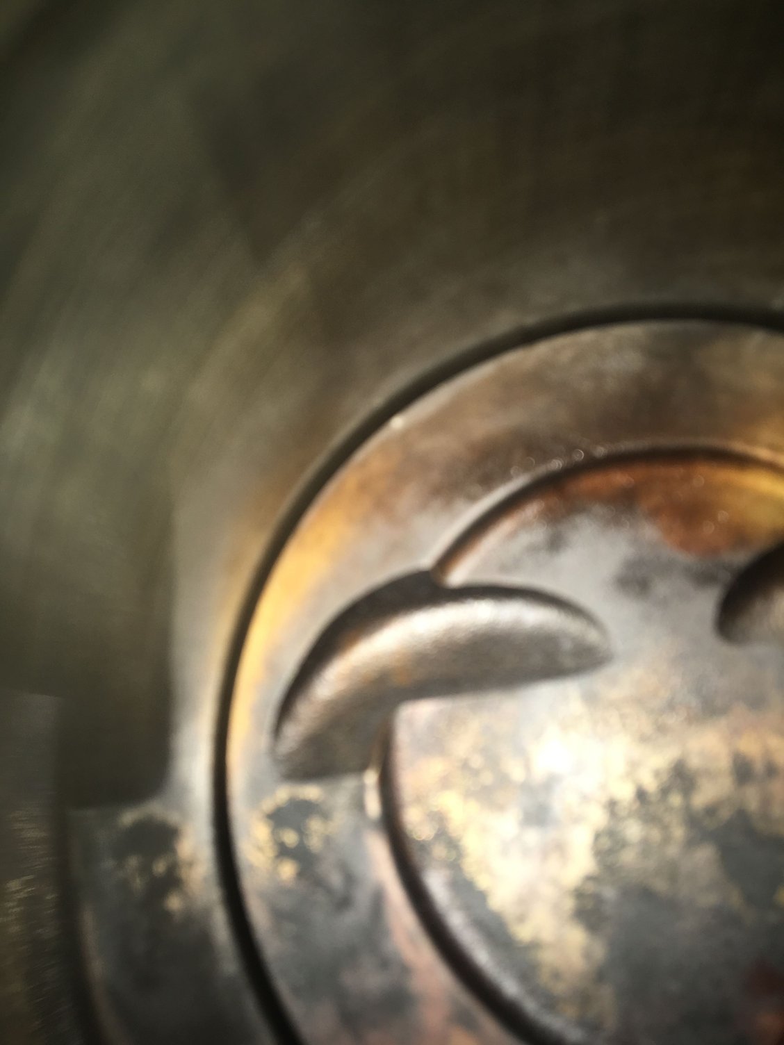

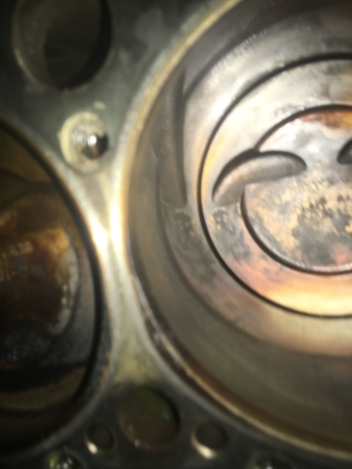

Here are a few pix. Heads look great. That lil line you see is a piece of grass lol. Heads were sent out and decked and valve job. before the rebuild.
Look at the intake valve. Look at the 6 o clock part of the head and piston. Looks really clean to me.
What do you all think???

What could cause this???
this is far beyond my ability but what am i evwn looking at insofaras the issue? the broken thicker ring?
